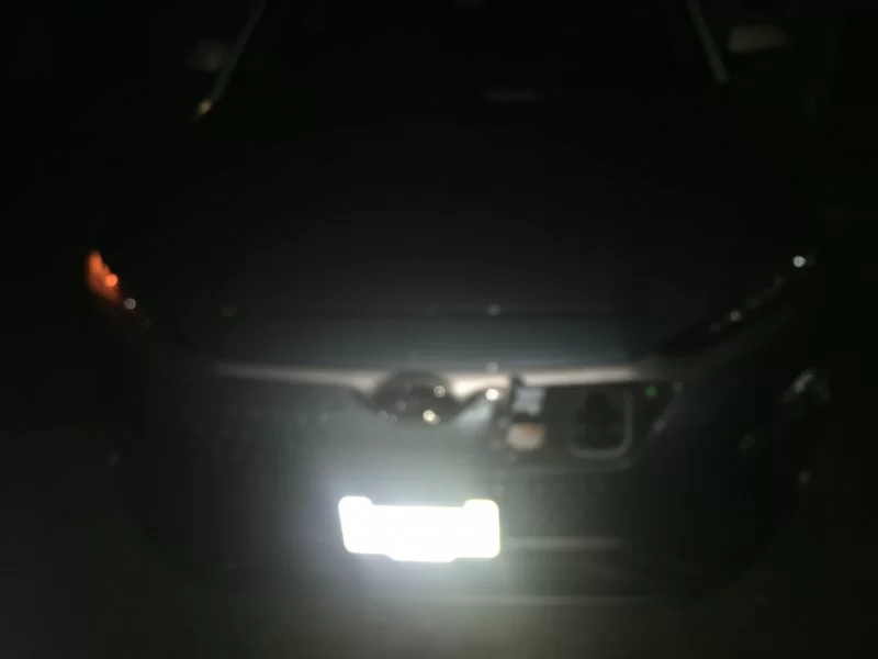

The attached picture shows the dimly light right front turn signal. The left rear signal was in a similar state. Both lasted for a couple minutes before going dark. You can also see the EV Battery is green. (80%)

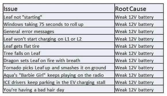

Leaf owners use this troubleshooting checklist.
Hahaha! Thank you for this informative list! :)

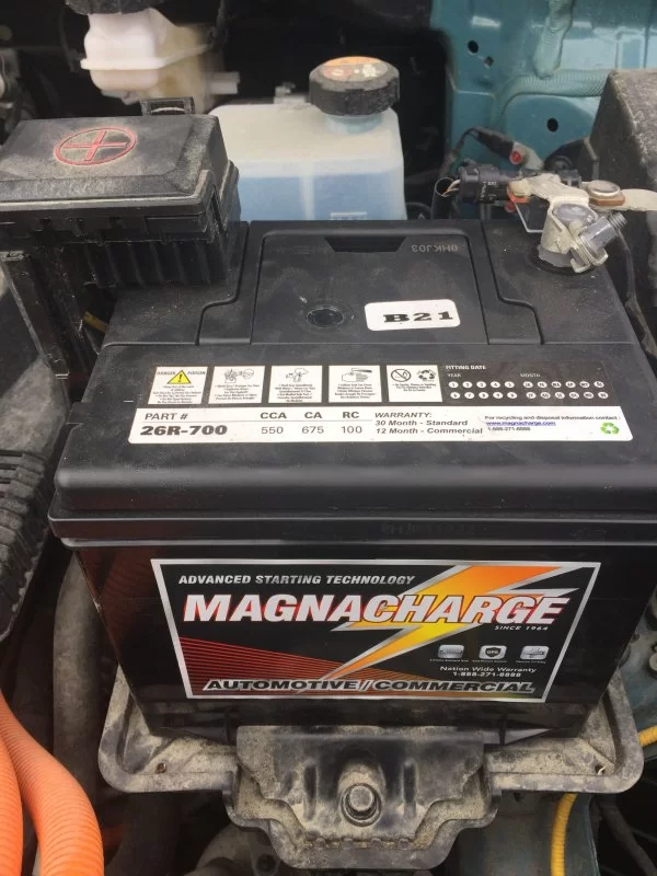

Clearly! I went to Lordco. They didn't have anything recommended for the Kona Electric in their system. So he looked at the battery and you could tell he had never seen one quite like that. lol. Anyway, we got one of similar spec. Maybe 1/4" taller and no recessed posts so the connections are a little tight, but otherwise fine. Nowhere for the plastic cap for the negative post to be secured to unfortunately so it is exposed. Might have to think of a way to protect that.
The OEM cover over the negative terminal is cosmetic only. You don't have to protect it, so don't sweat it.
Big blob of dielectric grease after connected and tighten down
