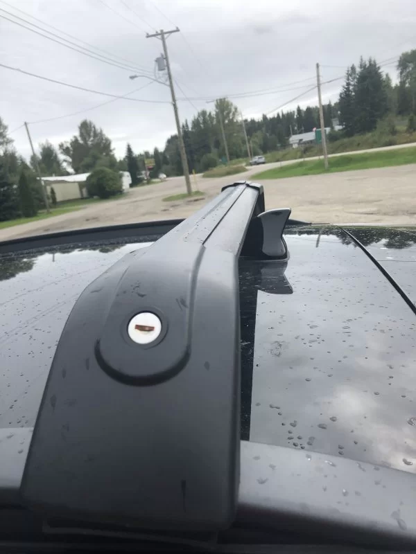

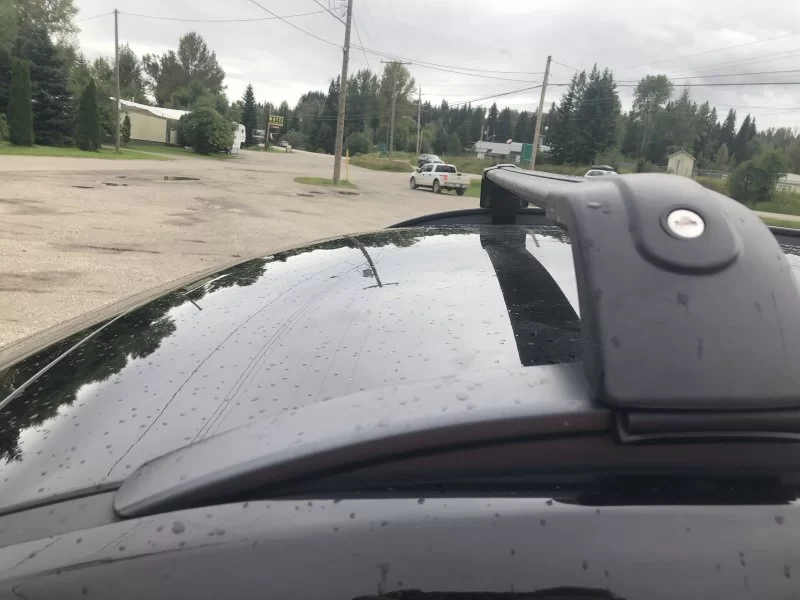

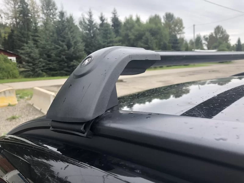

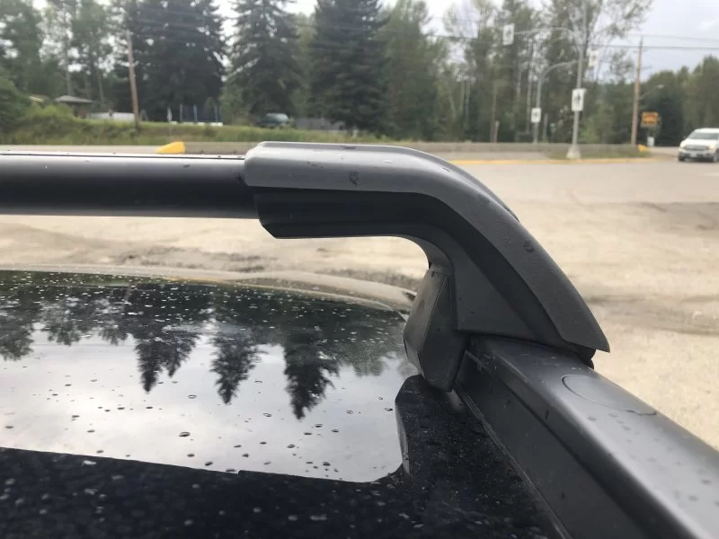

Can you post a close up photo of the point where you attach it to the roof rails? Thanks in advance.
after the first install I realized the directions/label was backwards and it should face the direction of the wind like an airplane wing where the directions had the pointed/sharp end facing forward, nothing “wrong” but they will whistle like a mad man that way.
Second issue was I didn’t read the directions clearly and I attached/locked them down -after- tightening the “widening” screws (the ones that let you extend them to the length needed) where you should let them “float“ loose and clamp the rail grippers to the rail First until they look snug, then tighten the widening screws so the whole setup is firm (otherwise they don’t quite grip the rail like they should and can pop off with horizontal pressure).
Finally I ended up pulling them right to both ends of the main rails limits because I have a rooftop bag and it doesn’t quite fit otherwise, not really an issue but more a note to give yourself the space ahead of time rather than having to redo it. Now that they’re on there snuggly they rarely whistle and pulling on them tells me they’re on there securely.
