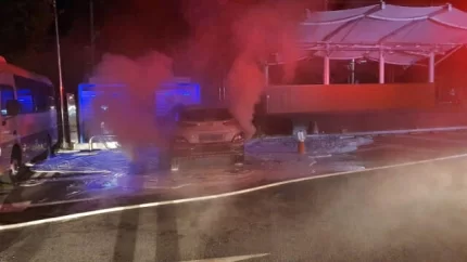

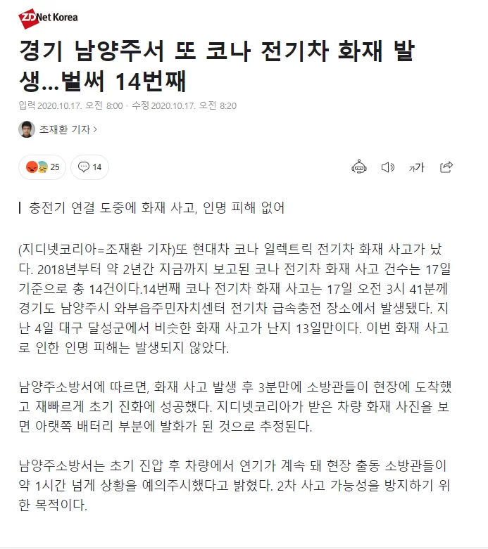

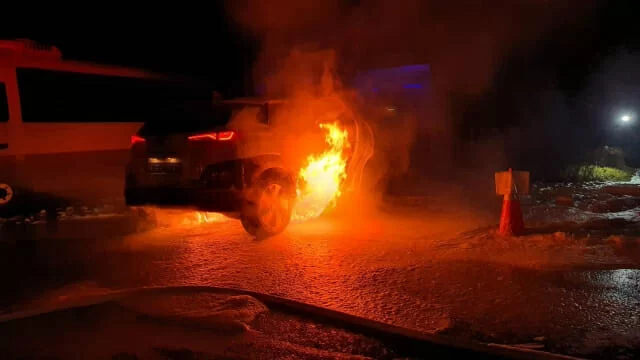

In addition, there was a fire accident in the Hyundai Kona Electric electric car.
The 14th Kona electric vehicle fire accident was held at 3:41 am on OCT-17-2020 at the electric vehicle rapid charging site at the Wabu-eup Community Service Center, Namyang-si, Gyeonggi-do. Occurred.
It has been 13 days since a similar fire accident occurred in Dalseong-gun, Daegu on the 4th.
No human injury occurred due to this fire accident.
According to the Namyang District Office, firefighters arrived at the site 3 minutes after the fire accident, and they quickly succeeded in extinguishing the initial stage.
If you look at the photo of the vehicle fire received by GDNET Korea, it is estimated that the battery part at the bottom was ignited.
The Namyang District Office said that after the initial suppression, smoke continued from the vehicle, and firefighters dispatched to the site were closely watching the situation for more than an hour.
This is to prevent the possibility of secondary accidents.
This fire accident was particularly noticeable when it was connected to a vehicle and a fast charger.
A total of two electric vehicle fast chargers are in operation in the parking lot of the Wabu-eup Community Center.
Both the Kona electric car fire accident in Jeju City on the 26th of last month and the fire accident in Dalseong-gun, Daegu on the 4th of this month occurred at the apartment slow charging site.
The vehicle in which the fire occurred in Namyangju was not burned down unlike the previous Daegu case.
The fire vehicle was moved to a separate location, and it is expected to be investigated by the National Institute of Scientific Investigation.

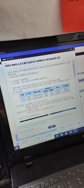

Hyundai Motor Company has been voluntarily recalling some of the Kona electric vehicles from Oct-16-2020.

I just awating confirmation that car has been LASTEST BMS UPDATE or NOT !!!
Yesterday has been started BMS update in korea by automaker..
