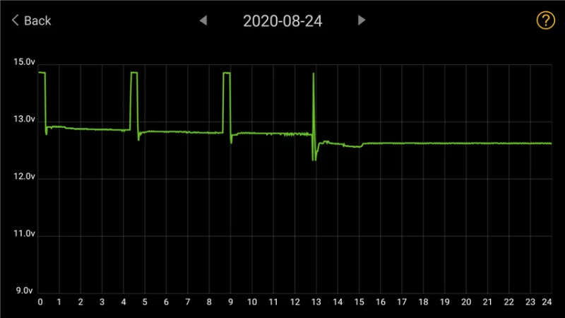

That is a good thing, the ring light in the charge port will also activate. This is the LDC ( Low voltage DC/DC converter) trying to charge the 12V battery on a regular basis, details of which are documented in this thread, It can also come on when performing a test on the cells themselves, however when doing this test (usually ~ 80% SOC HV pack), the odometer does not glow. A sample of this DC/DC action here:
You may also notice action on the louvers in the grille indicating the same.;)
