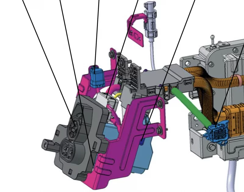

Sounds like the door closed sensor (or the harness wiring) located on the back of the actuator, is defective. Recommend to take it in, as the nose will have to be removed to repair it.
index.php
Thanks to @KiwiME for the diagram:
https://www.insideevsforum.com/community/index.php?threads/charger-door-wont-open.10100/#post-117262
