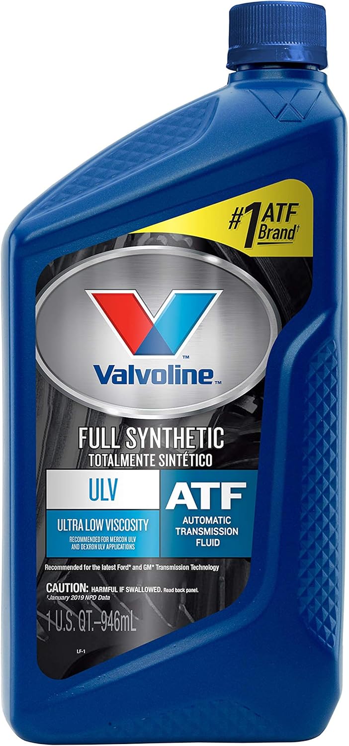

Some of the more adventurous and technically-knowledgeable Leaf owners over at MyNissanLeaf are experimenting with a ultra-low viscosity ATF. This would be ideal for the OP because a thinner oil will reduce or eliminate this noise. ATF oils in general are a more sophisticated version of the 70W GL-4 that our Hyundai/Kia EVs already use with the same viscosity and extreme pressure rating but also with friction modifiers to suit the clutches. The Leaf gear reducer is almost exactly the same design as the one we have and is specified to use an ATF. This ULV ATF has a viscosity of 4.5 instead of 6 at 100°C.
https://www.valvoline.com/our-products/automatic-transmission-products/ulv
