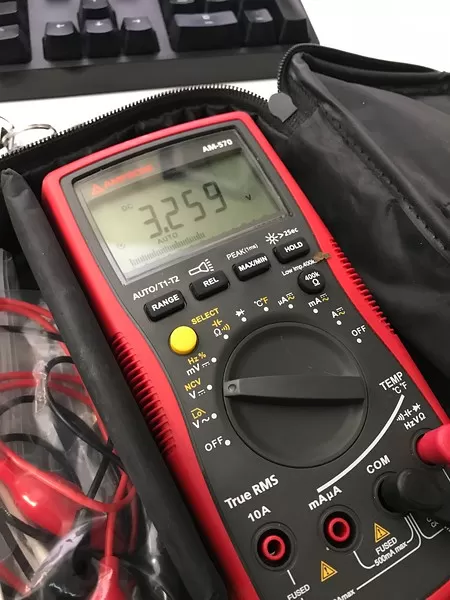

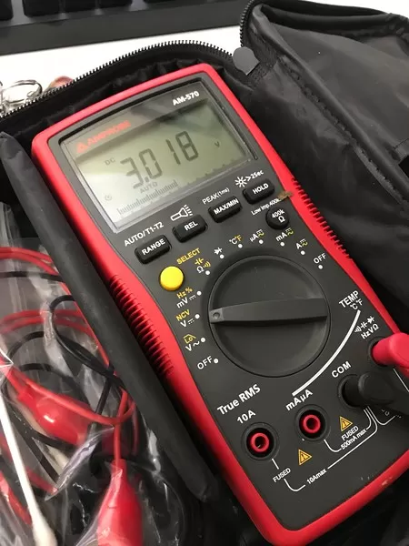

Mfd is 07/2018... I'll check voltage on battery but I doubt the battery could go bad this quick.
Pick the low hanging fruit first.
Try replacing the fob battery.
Having to hold it so close may be the diagnostic give away.
Let us know if that helps.
1) Low battery in fob, 2) fob signal blocked by fob jacket (or pants pocket faraday cage) or 3) interference with cell phone in same pocket.
I would say check for nearby interference... such as other key fobs, bluetooth/wireless devices, etc... I ran into this issue before with one of our cars (not Clarity). Turned out that my friend's key fob was interfering with mine. Every time he's nearby my car, my key fob cannot be detected.
Just checked on the battery, running a bit on the low side, so I've replaced both key fob's battery with fresh 2032s. I'll try to not put fob and cellphone in one pocket.
I noticed something interesting when I was charging my car, that the electric interference is so strong when I turned my iPhone on near the car to try to take photos of the dashboard through driver's side window, my camera app is totally screwed up and is constantly flashing the screen... I had to unplug the charger from wall to be able to take any photos... I would definitely not want to charge the car anywhere near where people are hanging out, for health reasons...
Old Battery
Fresh Battery
