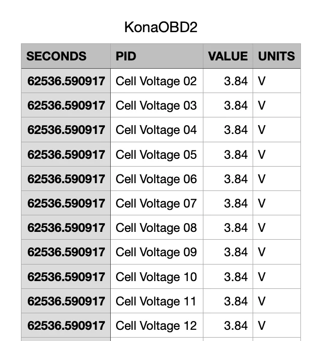

Sample file here: KonaOBD2.csv.zip

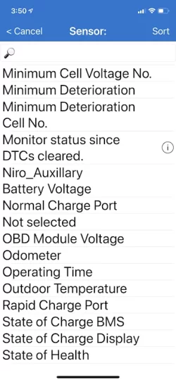

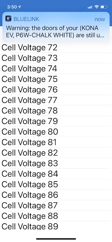

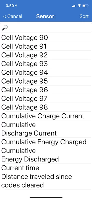

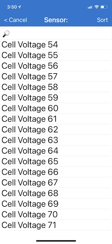

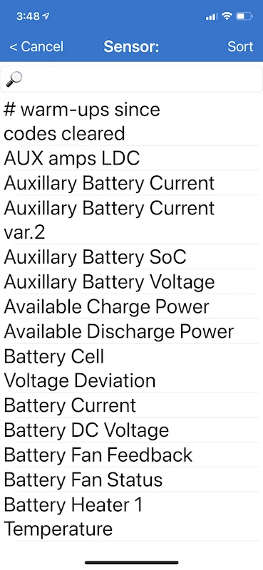

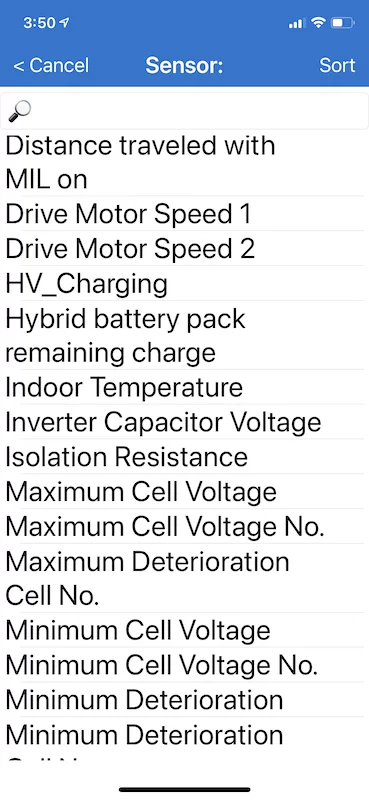

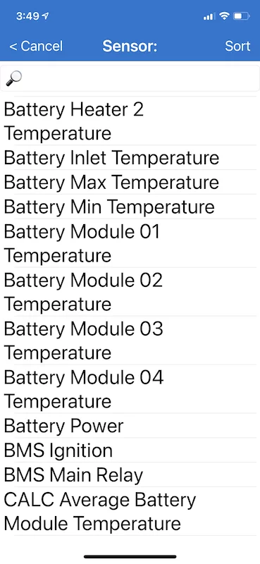

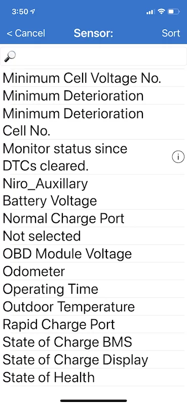

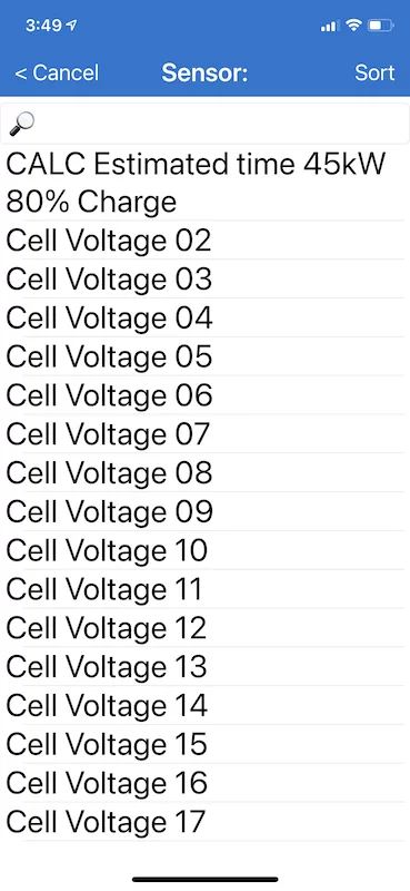

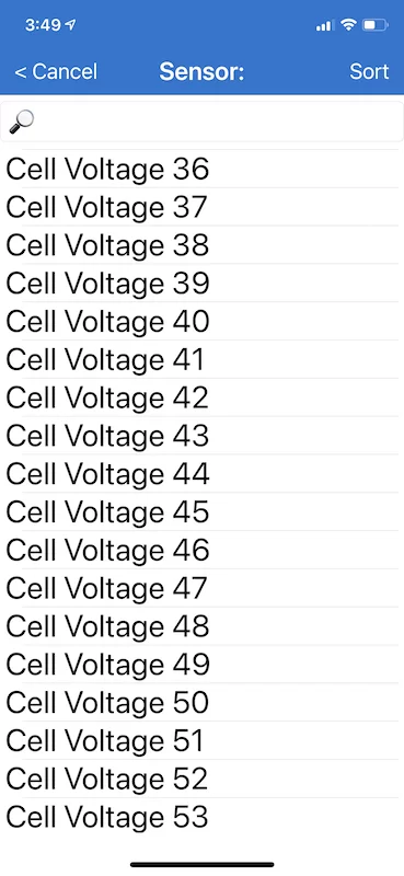

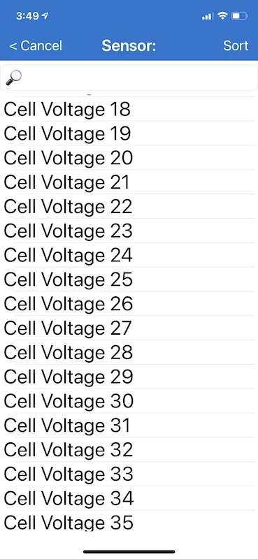

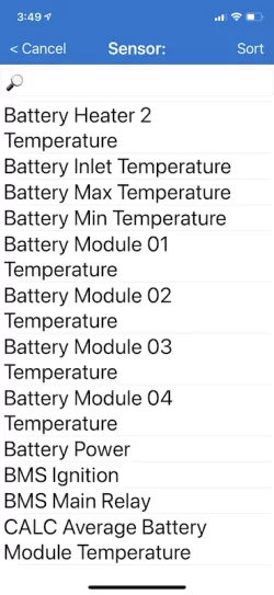

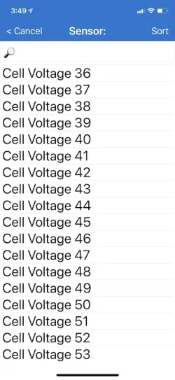

Car Scanner Pro has a profile for the Kona EV. Relatively easy to create your own multi-page Dashboard to view anything listed in the attached images. Car Scanner is available to iOS and Android. I use the iOS version.
View attachment 9696 View attachment 9697 View attachment 9698 View attachment 9699 View attachment 9700 View attachment 9701 View attachment 9702 View attachment 9703 View attachment 9704 View attachment 9705

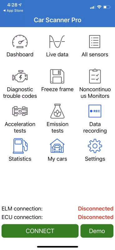

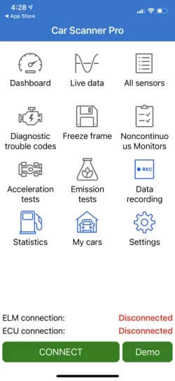

This is fantastic! Thanks. Can't find the app 'Car Scanner Pro' for either my Android or iPhone. There is a Car Scanner though on the App Store. Maybe it has a PRO (paid) version? Which is OK.
In the App store it's listed as "Car Scanner ELM OBD2". In the App itself it's titled as "Pro". I got it a long time ago but I'm guessing Pro is an in-APP purchase. It has a "Demo" mode that will help to get a feel for it. Be sure to use the Kona EV profile.
