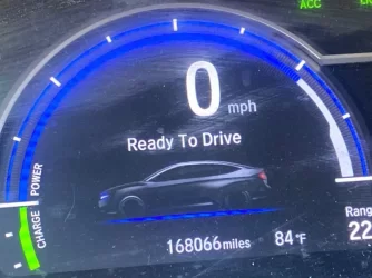

168,065 miles! Not only do I use the paddles for regenerative braking, I’ve mastered using the cruise control to slow down, or I use adaptive cruise control to stop when cars are in front of me exiting the freeway.
I still had 3mm left on them. New pads and rotors for $1200

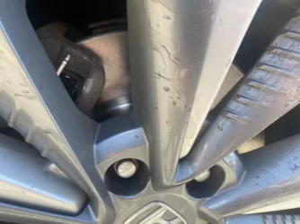

I just replaced the front brakes at 174,030 miles. One pad was rubbing metal. The other three pads had about a mm left. Rotors were badly, unevenly rusted.
Brakes and rotors from Rock Auto for $215. Took me about 3 hours. The driver side dust shield had rusted loose, and I had to find some washers to hold it on. The rotor retaining screw on the passenger side was stuck, so I drilled it out.
Brake job was the same as any most other cars, except stuff is bigger and heavier. Alldatadiy.com has good information in subscription on their new version of the website.

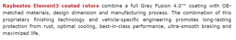

I just did mine all the way around at 73k, not because they were worn out, but because they were warped from rust. I went with the coated raysbestos rotors and Bosch pads, which came with all new caliper hardware too. Ended up paying $315 in parts, and did the work myself. Trickiest part was retracting the rear brake calipers without a scan tool, but that was solved with a drill battery and some wire.
I went to the Raybestos site to read about these rotors. The chuff-chuff-chuff sound of the rusted rotors makes our 2018 Clarity with 15K miles unpleasant to drive. I'll be interested to read about your experience with these rotors.
