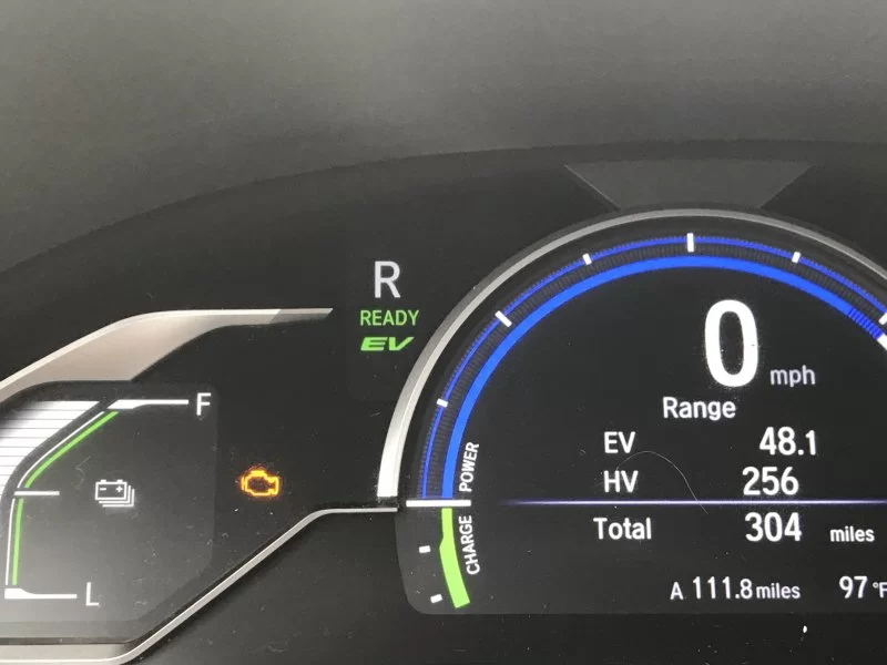

just charged at a public charging location. Now engine light on. Car is 13 days old

First thing to do is take off your gas cap and make sure it is on correct and sealed tight. Next take it to any autoparts store as tell them your CEL is on and you would like to pull the code. This is free and they may just hand you the OBD-II code reader and have you read the code yourself. The OBD-II port in underneath the dash on on the left side of the drivers side. Just in case you are unfamiliar with what it looks like below is a picture. Picture is not of the Clarity's but the port looks the same and is in the same general area. Record the 5 alphanumric code (that will most likely start with the letter "P") and post it in this thread and we will help you figure it out.

The Clarity has some issue with public charges, voltage fluctuations or something. Did it stop charging partway through?
If you have a loose gas cap it sets off its own information message "Tighten fuel cap" or something. I had it and it is annoying. After tightening gas cap several times it finally went away. I think it took a certain number of starts actually (so don't worry if that message stays up after tightening fuel cap).
Many check engine lights go away on their own as they are just something reading out of range temporarily, but they should be checked to see if it is important or not. If you don't want to go to the Honda dealer, stop by the parts store as AnthonyW suggests, come back here and report the code. Or just take it to Honda dealer.
As a test, stop the car, start it again and see if it is still there. Maybe repeat a couple times, it might just show for 3 starts or something like the tighten fuel cap message. It will still be stored in memory so the dealer should be able to pull it still.

When I got gas last night, after driving 200 miles, the light went off. Maybe it was gas cap, although I tightened it after someone recommended. So we will see.
