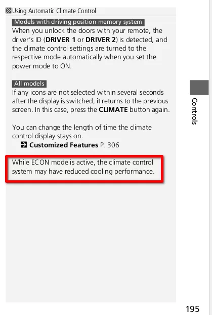

I’m almost always in Eco. The A/C always performs well. I’d suspect that Eco limits heat output more so than A/C output.
Very well could be. I just remember seeing/reading that it "may reduce HVAC output" or similar so figured I'd throw it out there. In CT the A/C keeps up just fine if it doesn't have any leaks in the condenser...
You are correct... It would be interesting to know precisely what the mechanism is, but here is the relevant citation from the manual.
The wording is odd because it say "may" have reduced cooling performance.

Econ definitely limits power consumption from the climate control system, if were to believe the manual. The analytical forum members have discovered that heating uses more power than cooling. Hence, my conclusion that reduced cooling might be less noticeable than reduced heating. Just a hunch.

So ECON mode was never a factor. I do think my AC is anemic and may need some repair or recharge.
