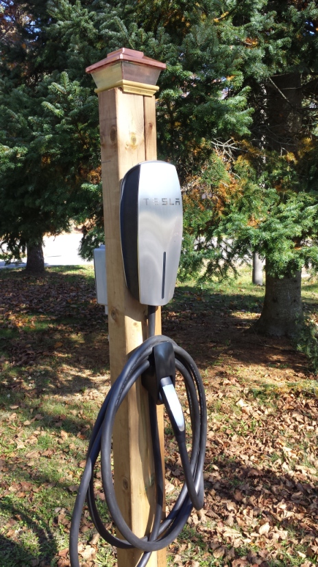

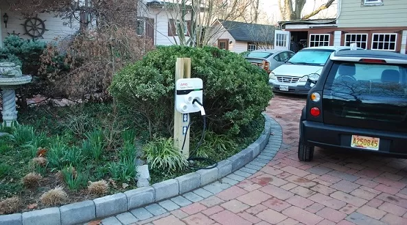

In case you park a bit of distance from your house, so an EVSE mounted on an exterior wall is a bit too far and lead to trip and fall hazards, one could consider installing it on a post, with the wires leading to it buried in a pvc conduit. Here are a couple images I found.
