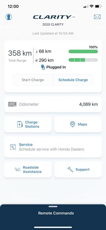

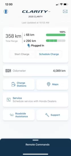

Jay777
Is this Ev range normal in the summertime? The best I got so far is 76km. But normally under 70.
So much depends on driving habits. The gauge is just an estimate that is calculated based on previous trips.
76km is 47 miles, which is what Honda states as the EV range. I’d say that’s normal.
In warm weather I’ve driven more that 62 miles (100km) in EV. I’ve also driven 40-42 miles in EV in warm weather. The 62 mile range was accomplished in slow traffic, the ~40 mile range was at 70mph. I’d consider both to be normal, given the circumstances.

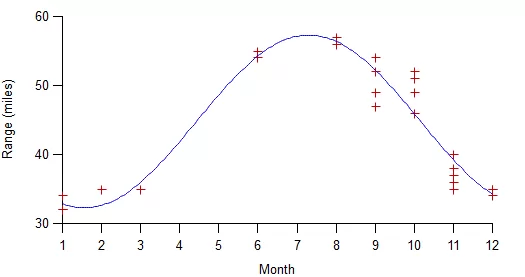

For what it is worth, I've had my Clarity for almost one year now, and driving 10,000 miles. I have not been extensively collecting data (each red plus is an actual charging result I recorded), and I have a gap from this spring in not driving much at all due to COVID-19. That said, for upstate NY, I think the fit represented by the blue line is actually pretty accurate on what to expect each month. In these warm summer months, I routinely get a range of 54-58 miles, and the coldest winter months, this drops to about 32-35 miles. Agree with previous posts that results will vary greatly depending on the nature of driving and climate settings, but hopefully this gives some insight as to what is possible.

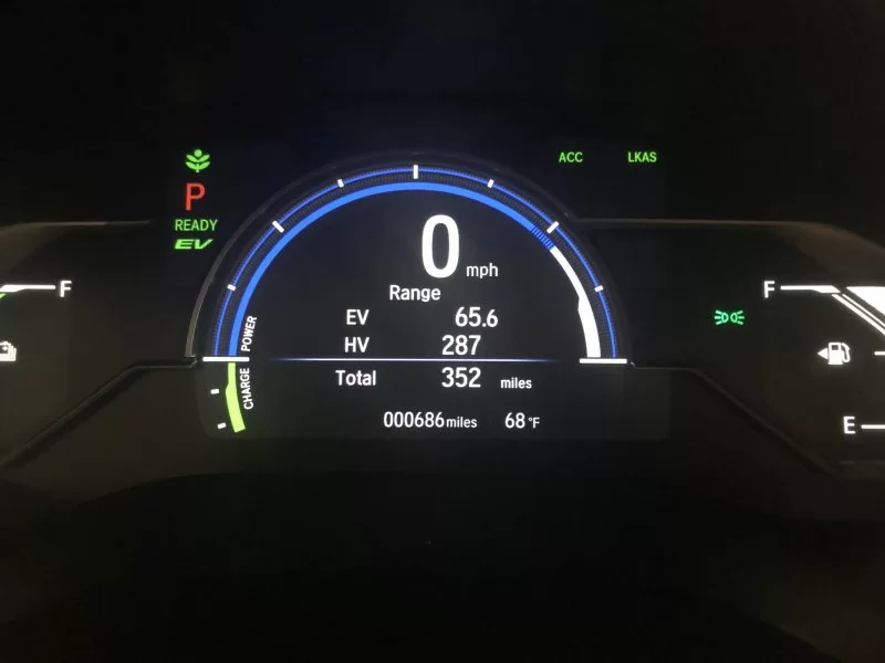

We timed it just right to view a spectacular sunset. After the obligatory photos, we descend back down the 4,000’ towards home, picking up just over 20 EV miles on the way down (11 to 33). My assumption was that next drive our EV range might suffer, what with the long climb and all not quite being canceled by the descent miles gained.
I assumed wrong! The following day showed 67 estimated EV miles, best I’ve ever seen. My thinking is that the car averages out the last several drives, but must more heavily “weight” the very last drive.
