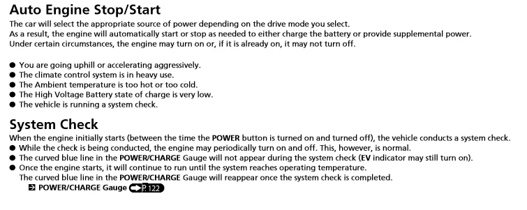

The car will perform an occasional "system check" to make sure the engine is working correctly. From the manual:
So I would say there's no need to manually turn on HV mode every so often -- the car will do that for you when it determines that it's necessary.
Slightly different from the "fuel going stale" issue, but I think there's no need to worry about the ICE being damaged from lack of use.
