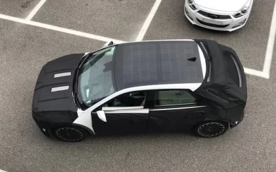

More info and a picture of the Ioniq 5 with a solar roof can be found here:
https://thenextavenue.com/2020/10/29/hyundai-ioniq-5-will-have-solar-panels-on-its-roof/
Getting 10-15% of free charge is a great thing either way.

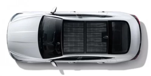

Here's the IONIQ 5 solar roof on top and the Sonata Hybrid solar roof just below. They look exactly the same, so it's likely they are (more below images).

Found a great page with lots of Sonata hybrid solar roof info. "The Sonata Hybrid’s solar panels have a capacity of approximately 200W (204 to be exact); that is, panels exposed to the Sun in good sunlight will produce 200Wh of electricity."
Also, "The cells on the Sonata’s panels have a 22.8% efficiency rate, roughly 30~50% higher than the rate for the typical cells used on rooftop panels (15~19%)."

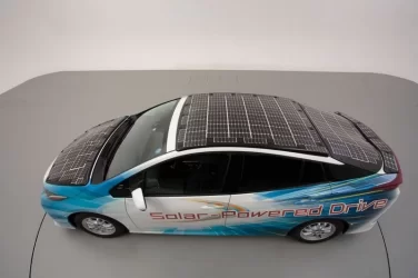

Just for comparison, this Prius Prime has been fitted with high efficiency solar (in 2019) and is said to produce 860 watts, adding 44.5 km (27.65 miles) a day.
This wouldn't sell in big numbers, I think, butI would not be surprised if, in the future, we see solar panels on hoods too, but integrated so that you can't tell they are there.
