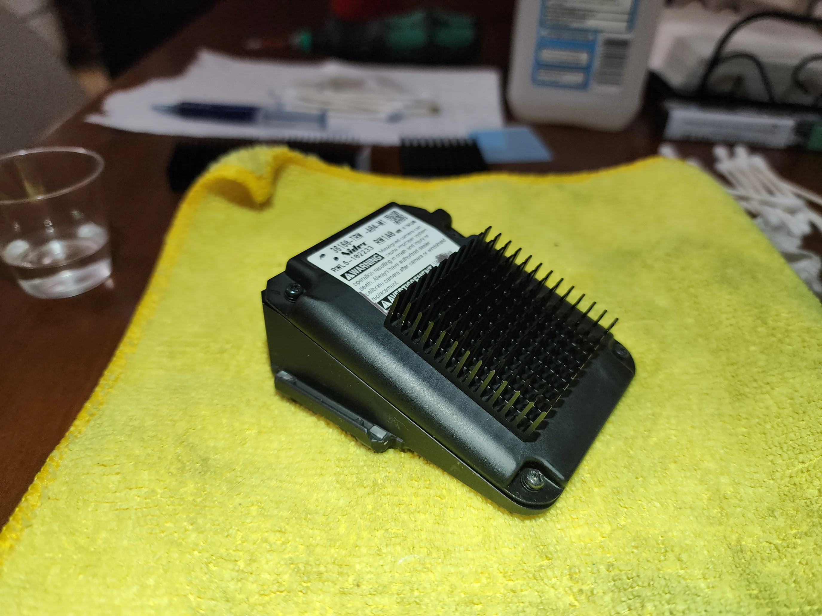

I was extremely lucky and found a used Camera in a week from a dismantler here locally in California. I plan to test out out the camera and make sure it works, then remove it, take it apart, replace the thermal paste and add a heat sink to the outside.
Please share any and all pictures you get Geor99.
Ok. I definitely will. I'll do it this weekend. Ill post what I did having access to free materials and parts at work, and I will post what I recommend for the average non-engineer. I'll keep the costs under $10 and the time to complete under 30 minutes.

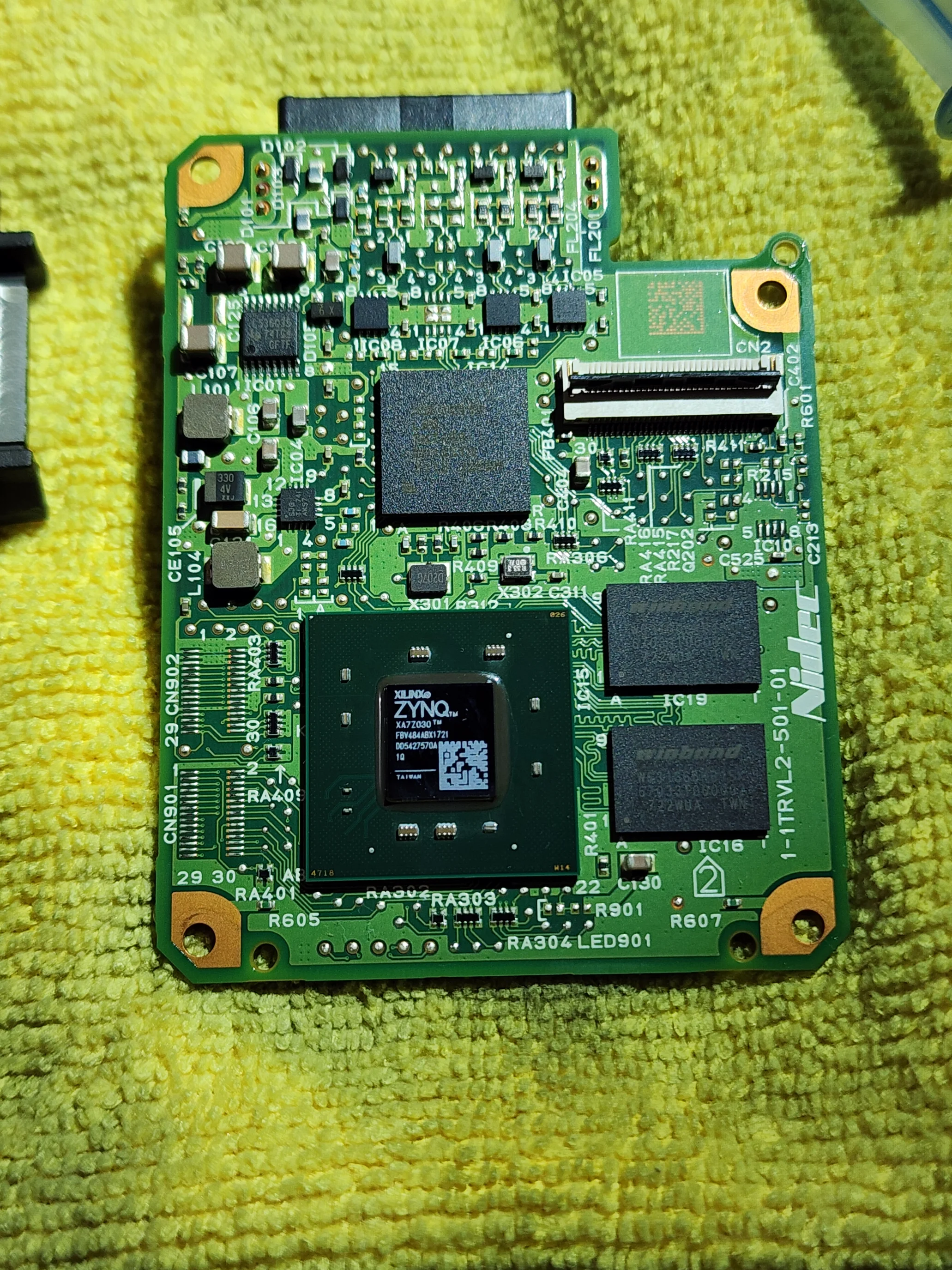

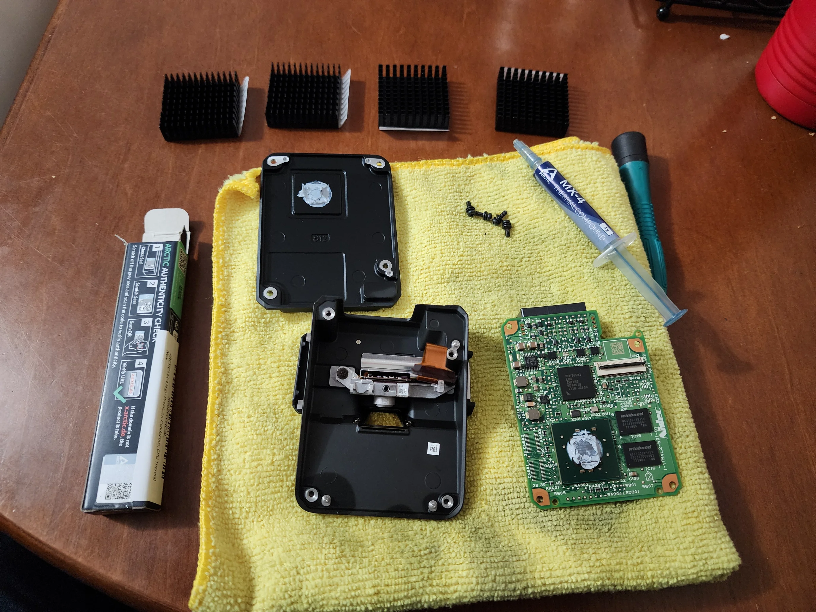

The easy version will be sufficient to keep the microchip junction temperature below what data sheets for the chip recommend as the max temp. It's basically removing the top via 4 Philips screws, cleaning off the old with isopropyl alcohol and replacing the thermal interface material. Then I added a low profile heatsink - I'll attach the link to the part. I then mounted a low profile fan with a thermal fuse, so that the fan only turns on when the case gets warmer than 105F, which has actually been rare with my new camera, but the fan will occasionally turn on.
Since the fan so rarely turns on, I wouldn't say that it's absolutely necessary. Things will be fine for the vast majority of people if they just change the thermal interface material (5 minute job and costs 3 bucks) and add a new heatsink - also cheap and easy.
When I removed the top on my failed unit, the thermal interface material was dry and dusty. You want it moist. You see, the biggest speed bump for heat transfer is pockets of air. Heat can't travel through air very well at all. When you want to move heat from one plate to another, even if they seem flat and smooth and you clamp them together with solid force; on a microscopic level there will still be pockets of air between the plates.
A wet seeming thermal interface material is a peanut butter consistency grease that goes between the 2 plates and fills the microscopic air bubbles with itself. Only a very very thin layer is needed and clamp the plates together as much as possible by tightening the relevant screws.
Getting rid of the microscopic air bubbles makes a much bigger improvement for the thermal transfer than one would think.
This dries out in dying cameras and is probably why so many cameras have died. Cheap thermal interface materials only last a few years before drying out.

This was my unit that's bad. The Thermal paste was not completely dry but kinda. I cleaned it off and added some thermal paste. occasionally It works for a drive and comes back so it seems to be on its very last toe...
But yes I agree I was extremely lucky. I co worker gave me a couple dismantlers he uses and 3 calls later, BAM i found it. $300 shipped to my door with 30 day warranty that it works.
