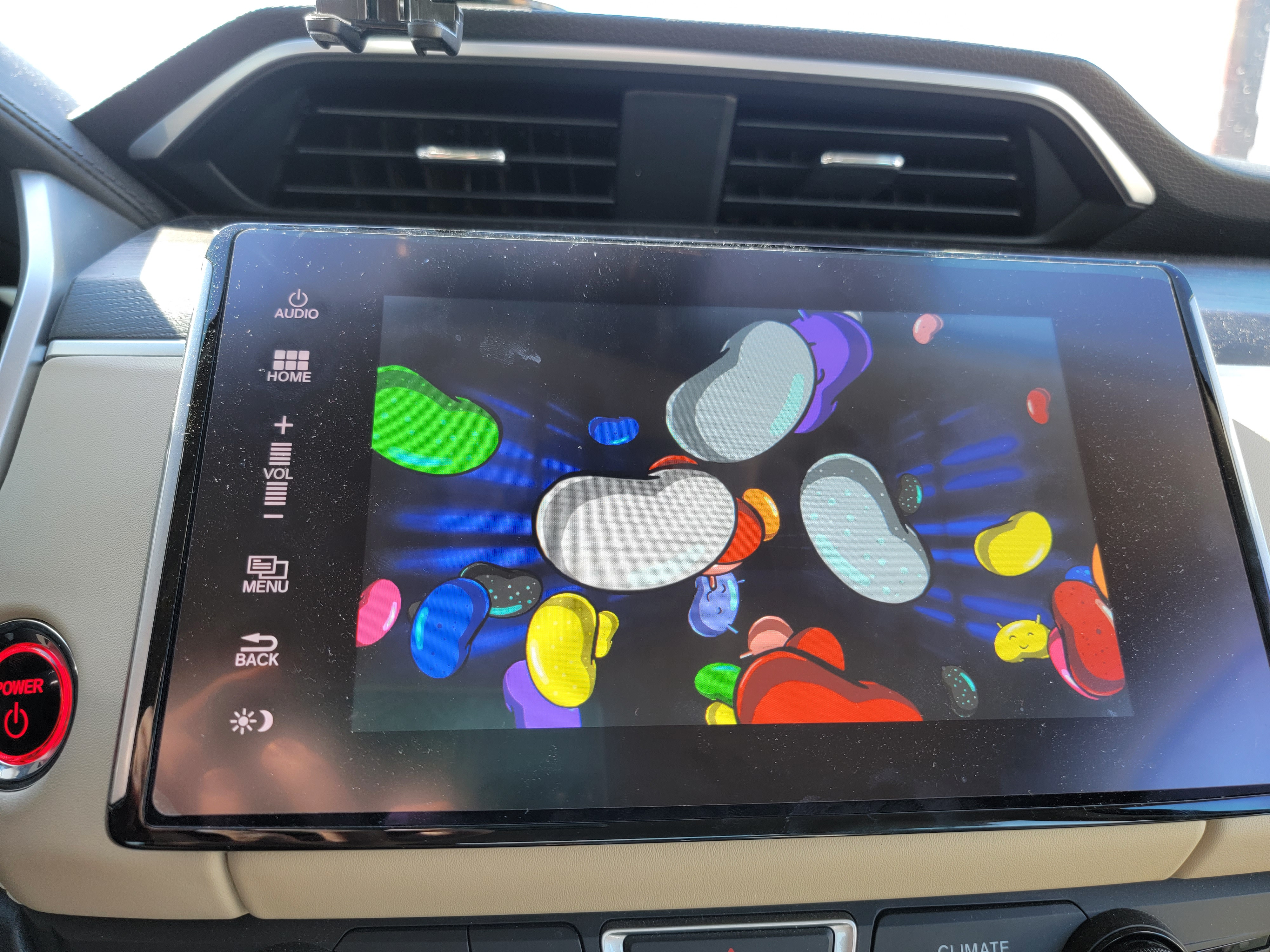

About that little Android Tablet screen on our dash...
General Specifications
Manufacturer MITSUBISHI ELECTRIC
Model MY16ADA
Android version 4.2.2; 64; SDK17
CPU 4 cores; ARMv7 Processor rev 9 (v7l) tegra; Max: 900.0 MHz; Min: 450.0 MHz
Display 800 x 480; DPI: 160; Evaluated Size: 5.8"
Touch screen Multitouch 4 points
GPU NVIDIA AP; NVIDIA Corporation; OpenGL ES-CM 1.1; OpenGL ES 2.0 16.05001
RAM 1024 MB (988 MB available)
Flash 8 GB (7.031 GB actual); 931.513 GB (see memory map tab)

Yes, this is sometimes entertaining for a number of reasons.
The build.prop is interesting. I will post a reference version for our car later as it is slightly different than what I found in other Honda variants (Accord, Civic, etc - ones that have a knob).

Honda hacked my HU yesterday. Been having way too much fun since. Managed to get to the 4.2.2 "easter egg" game in Android (remember those?) by installing Shortcut Master (lite) and finding com.android.systemui.BeanBag in the App Explorer.
Now that I'm HH'd I want to do a couple different things. I got it so I could use Head Unit Reloaded and make the HU wireless Android Auto capable. Good news and bad news on that front: it's entirely possible! I got it working at least once. The bad news, is that it's a bit slow (not as slow as running Google play services, but not zippy as usual) and involves a lot of setup. Here's the guide. I'm using WiFi method #2 until I can figure out if the HU is capable of starting a hotspot, which doesn't look possible so far. By all means, someone please prove me wrong.
The only other ideas I have ATM are to find a lightweight game just for fun, or potentially try and unlock the maps functionality on my non-touring PHEV. Pretty sure it's out of my pay range, not to mention illegal, but a man can try. For educational purposes of course
