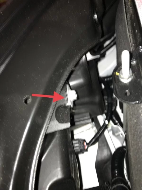

Thanks to posts here I found the screw that adjusts them up and down and using the above procedure helped. But I can’t find any adjustment for the high beams or for right to left. Has anybody found these??
If you look directly behind the lights you’ll see a slot at about a 45 degree angle and a toothed shaft that you use a Phillips head screwdriver to turn (also has a bolt head for a socket or wrench). Pix of passenger side one:
