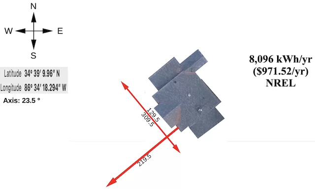

I use this solar calculator: https://pvwatts.nrel.gov/ It provides the estimated power my contracted, solar roof:
  • 28° roof pitch
  • 16 four hundred watt panels
  • adjusted for roof directions, latitude and weather
  • 8,096 kWh/yr
If your solar panels are mounted on a sun following structure, you can get the maximum power. Then have a hurricane proof, storage for the panels.
I have two EVs so one is on charge while I drive the other. My EVs typically get 4 mi/kWh so I should see about 32,384 miles of EV range over a year.
  • 28° roof pitch
  • 8,096 kWh/yr
My EVs typically get 4 mi/kWh so I should see about 32,384 miles of EV range over a year. I have two EVs so one is on charge while I drive the other.

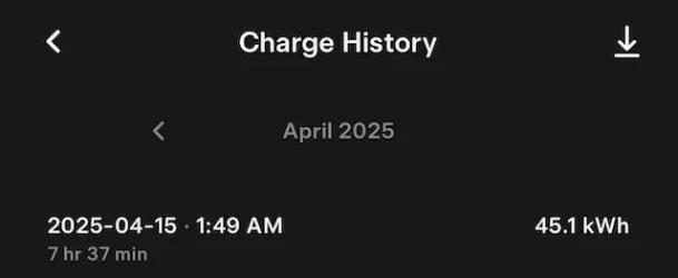

I would share these observations from my 2019 Model 3:
  • 4 mi/kWh - defines the driving miles as a function of added charge
  • 6 A - lowest charge rate amps
  • 120 / 240 VAC - typical voltage range from split phase, N. America home
    • 120 / 208 VAC - commercial 3 phase voltages
Today, my 6 year old, 150,000 mi, Model 3 has ~45 kWh battery capacity.
There is a triangular shaped charging curve. Measured at home, the initial rate was 7.4 kW and then tapered down to ~1.2 kW.
My home solar roof is not fully operational. But during testing, it generated 4 kW at 4 PM in the afternoon (for my configuration, sixteen, 400 W panels.) My best estimate from an EPA solar planning web page is the daily production should annually average, ~25 kWh per day.
Given these recent metrics:
  • 2/3d (16.5 kWh) - EV charging, ~66 mi per day
  • 1/3d (8.5 kWh) - house usage per day
I would recommend adding a high efficiency, electric bicycle for local, emergency transportation and leave the EV for longer range, larger payloads, and passengers.
