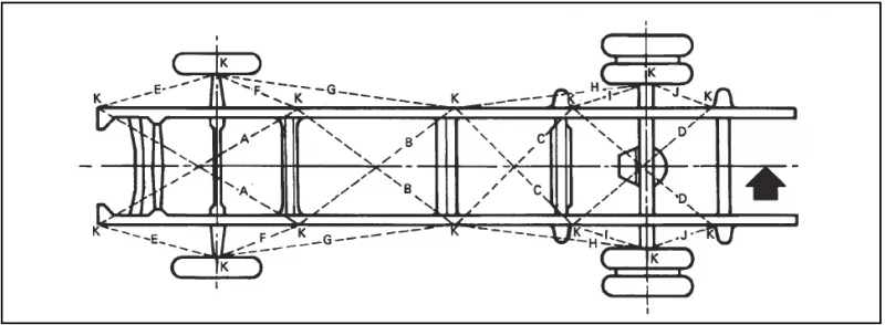

A class 8 frame is a different being. It needs shearing/compression strength to carry loads, Any impact will be minimum on the cab. So even if the frame is die cast, the cab is not.
bodybuilder.navistar.com/General/Documents/Saleinfo/CT471dates/20140228/CT471/Series/DuraStar/Durastar_frames.pdf
