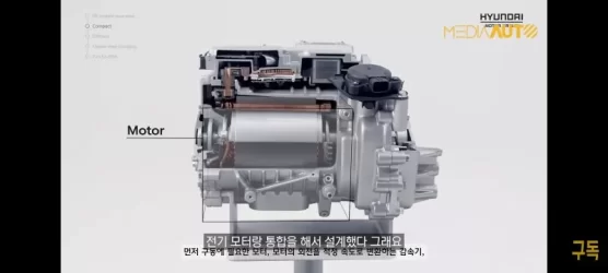

I think because of the volume of oil, the engine is flooded and therefore cooled by the oil.
I have not verified this ?!??
It's clear to me from the links and oil capacity you provided that it's a "wet" type motor, not flooded precisely but continually wetted for cooling and optionally bearing lubrication. The oil capacity essentially proves that. What we have is the E-GMP mechanical architecture but with a 400V motor installed instead of 800V. Aside from a wet motor, it would also correct the geometric overconstraint present between the motor and GRU input shaft by having two or three bearings in total instead of four. Hyundai/Kia are learning from mistakes that have caused grief for some owners, they just can't admit it.
This should hopefully put an end to the risk of the "tapping noise" and dirty oil issues. This model Niro should really have its own forum as there will be little in common with the outgoing model. I fully expect the next Kona to use the same powertrain.
