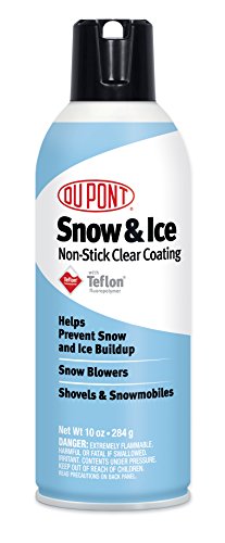

Amazon, and a lot of stores sell this coating, which works great on my snow shovel, but I don't know if it's compatible with plastic.
Hi Insightman I have a can and used it... 'maybe' it does some good; but in mucky weather the radar still gets blocked.. not sure anything aside from a mechanical solution would work (like those old-time comics with a hand controlled with pulleys :-) )
