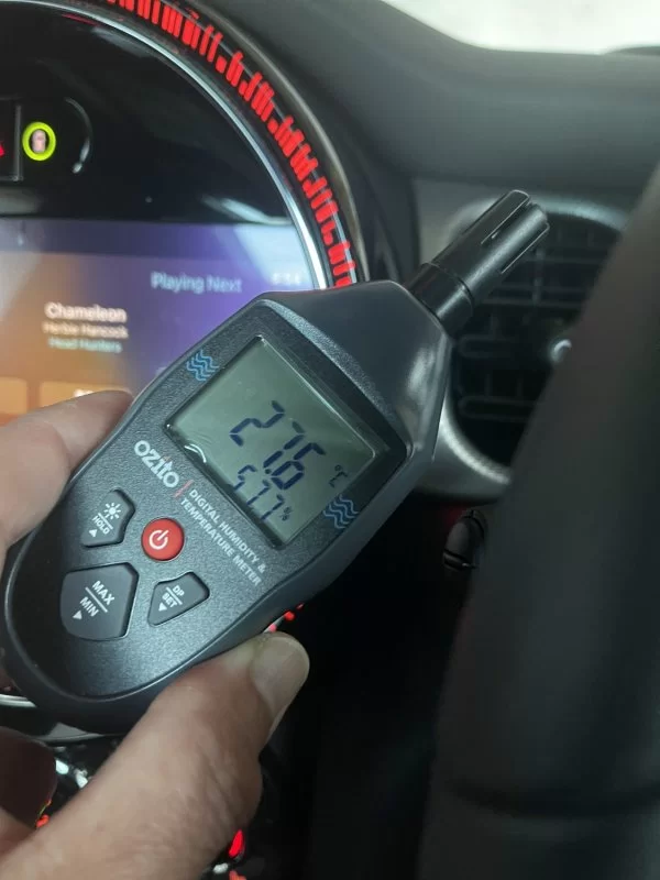

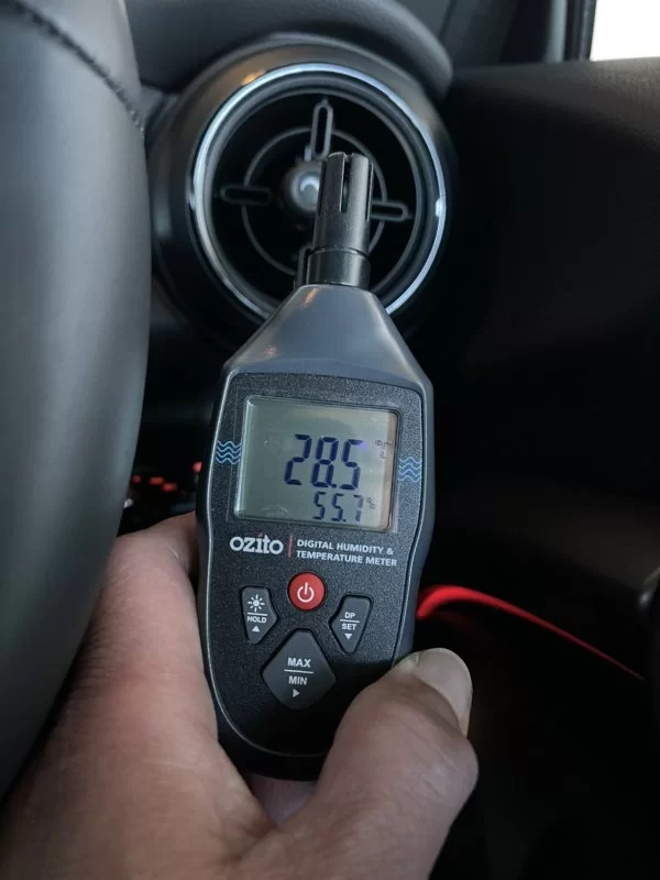

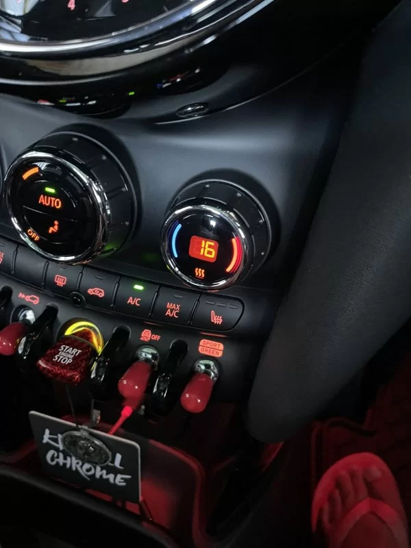

The AC on our SE has been acting up again on the drivers side, i.e. the right side. Warm air was coming out. I used a temperature meter to measure the warm air coming out, it was 28.5C on the vent near the door and 27.6 on the other vent; but the AC temp was set to 16C.
The passenger side i.e. the left side of the car was perfect at 18C.
Will be booking it with the dealer to have a look.
Could just be the freon needing a top-up
If one side is working then I expect the problem is with the valve that controls the cooling on the other side.
