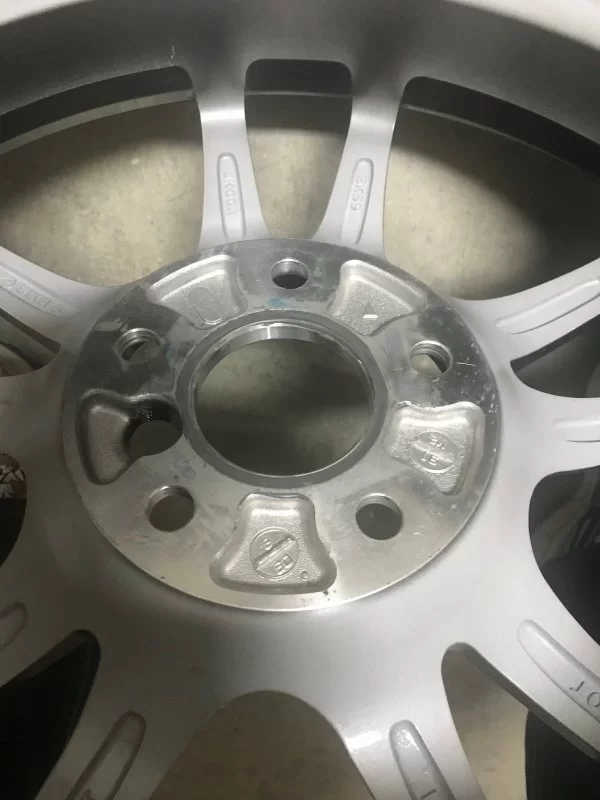

Here is a photo of the wheel without the adapter:

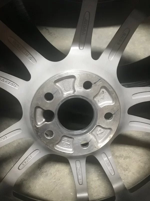

Here are a couple of photos of aluminum adapters I have installed in two spares using JB Weld to fill in the space around the adapter to make it flush with the surface of the rim (Infiniti and Nissan recess the 66.1 mm surface into the rim a little, so there is a slight gap to fill when you insert the hub centric ring and leave the lip flush to the inner surface of the wheel). You can see the dark gray ring where the JB Weld has filled the gap.

It is a little difficult to visualize completely without seeing them in person, but I am assuming the JB Weld is just aesthetics?
It seems like the ring would do it's job just fine without filling this gap...
Is the ring tight enough that you need to tap it in, or would it be loose and just fall out unless you bond it somehow?
I wouldn't feel good about it without the JB weld. The ring goes too far into the wheel (too far from the inner surface) if you don't use the JB Weld to hold it. If you look at an OEM Honda wheel, the wheel makes contact with the hub at the inner surface. You would lose that contact area (support) if you don't try to make the hub centric ring flush with the inner surface of the wheel and I don't think the added ring would really be helpful at all. It also fits very loosely (it would fall out without the JB weld).
