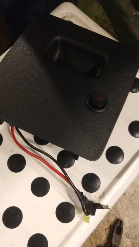

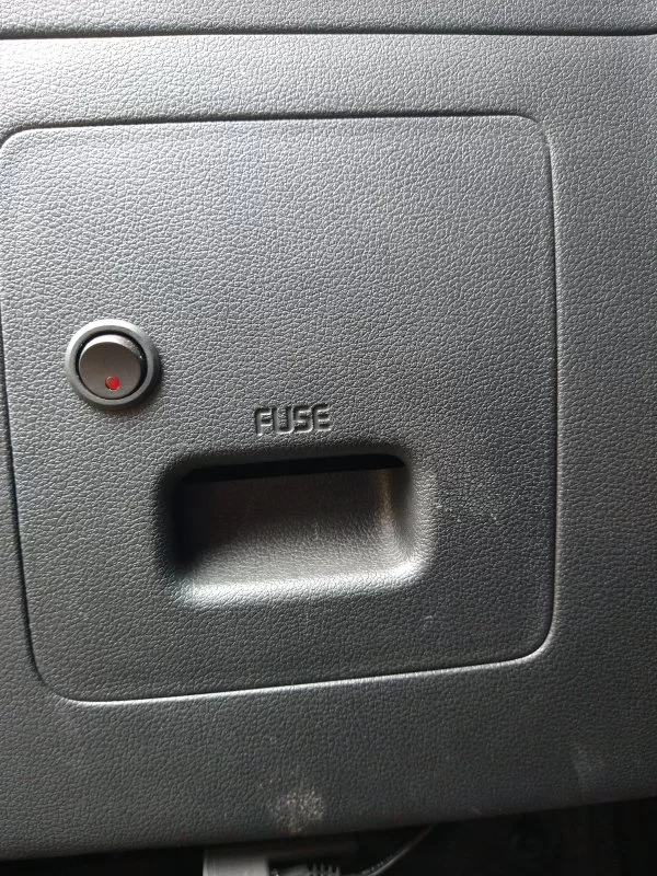

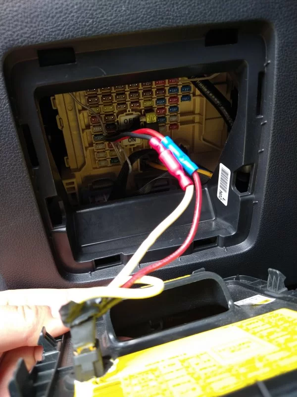

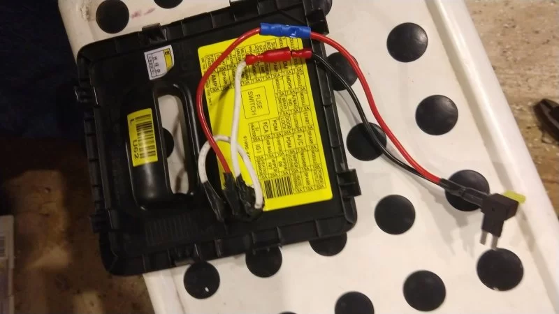

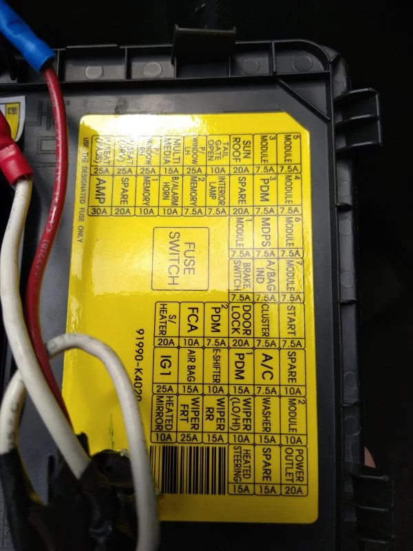

After many accidental butt cookings, which is really annoying in hot weather, I put a switch on the fuse panel with an ad a circuit. The drive mode and other buttons and features are not affected at all. I used the blade from a burned out fuse to hook up the switch in series to the ad a circuit, not the standard configuration.
