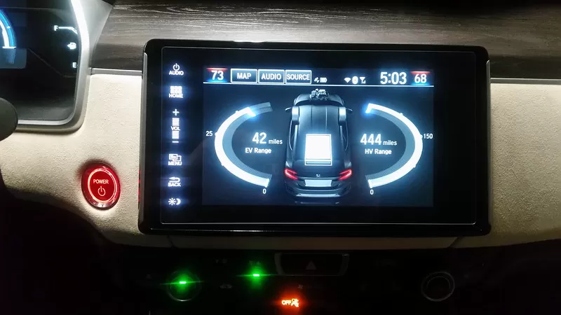

@Margo, to get to the display on your "tablet" on your dashboard: push home, push info, push vehicle energy.I must be missing something. How do you tell what range is left on the battery? I'd like to know how many miles I can drive before the gas has to kick in. Thanks in advance!

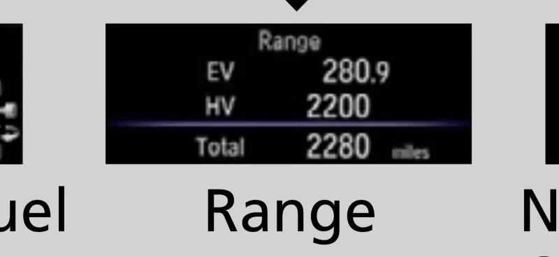

The only range I see on this is the combined gas and electric. I'm looking for just electric.Use the “I” button on your steering wheel to select “Range” options. This will you read-outs for both remaining EV and HV ranges. We have this option on at most times.
I've seen this screen, but no numbers. Maybe I have to be moving vs sitting in the garageAlso...

Ahh, just got in the car and found what you're talking about. I wasn't looking at the center readout options.The only range I see on this is the combined gas and electric. I'm looking for just electric.

OK, just did a little sanity check. You don't get a readout on the levels in accessory mode when looking at vehicle energy under info mode. I've been in the garage playing with the buttons...in accessory mode.
Yeah, you have to turn on the car to get to the display.OK, just did a little sanity check. You don't get a readout on the levels in accessory mode when looking at vehicle energy under info mode. I've been in the garage playing with the buttons...in accessory mode.

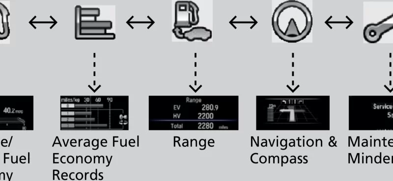

Found it. Thanks. Wish I was getting the range that they're showing in that picture!View attachment 3082View attachment 3083
- Press “I” button on steering wheel until “Range” option then select it
- you see EV range, HV range and Total
See attached images
Glad you figured out how to get the display for EV miles. Just remember that it is an estimate and that it will go down to zero faster or slower than actual miles driven, depending on how your power usage is differing from your previous average. So it is an estimate and not an absolute number. However every time it does count down to zero miles, it has used up all the SOC allowed and will enter HV.I must be missing something. How do you tell what range is left on the battery? I'd like to know how many miles I can drive before the gas has to kick in. Thanks in advance!
