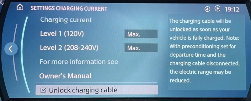

There is an option in the charging settings to enable/disable unlocking of the plug.

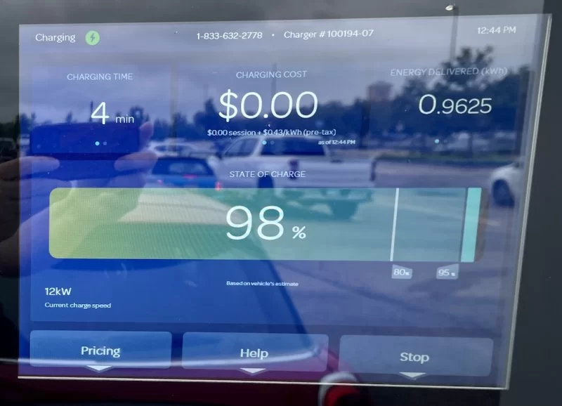

I ran the DCFC charge experiment today, and it definitely locked the handle during charge while the SE was locked. I inserted the Electrify America cable, locked the SE, and then was unable to remove the cable. I then started the charge session. When the SE reached 100% SoC I was able to remove the cable with SE still locked. I can't say how much of the locking was done by the EA charger and how much by the SE, but the SE certainly let me remove it when done charging. Further testing would be needed, such as ending the charge session before 100% SoC and see if the SE lets the cable be removed.
I thought it shouldn't take long to charge from 97% SoC to 100% SoC, but I was so wrong! It took 20 minutes to add 3% SoC, because the charge rate started at a meager 13 kW but dropped to 3 kW for the last 1% SoC. That's only marginally better than Level 1 charging.

I couldn't find any setting that unlocks the cable if the doors are locked. I don't know if Bimmercode could change it.

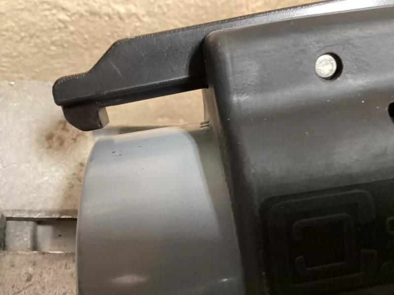

Once I charge SE in garage I never lock a car I can remove plug any time during charging but J1772 is mechanical lock with spring to correctly engage a charging port prevent from arc if you not plug fully and I don’t see any practical reason to play with Bimmercode to disengage that function.if someone don’t like a function bc you have to press a baton on top of J1772 to remove a plug just cut a tip of J1772 with hacksaw and you can remove plug freely if car is lock or unlock all the time.
