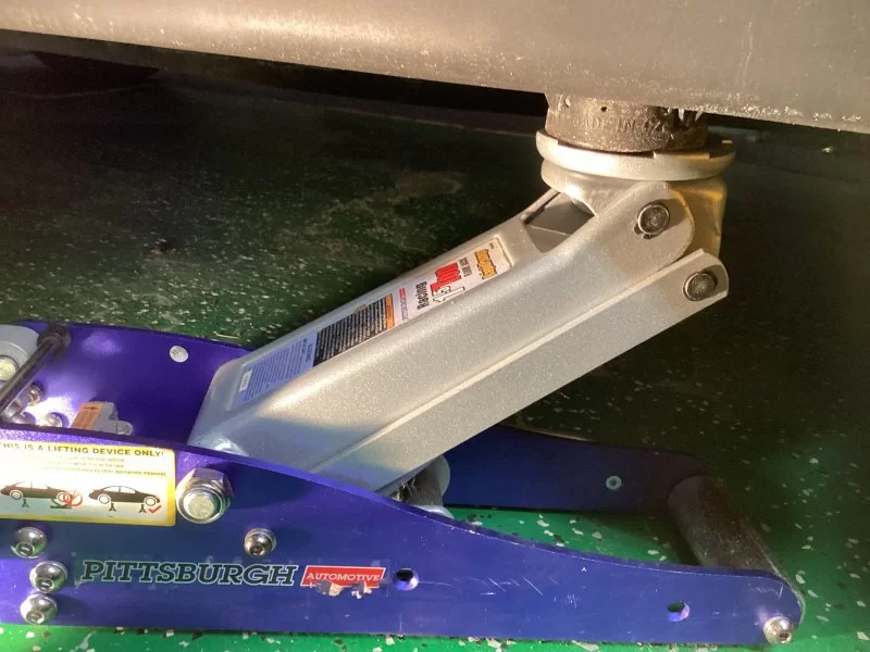

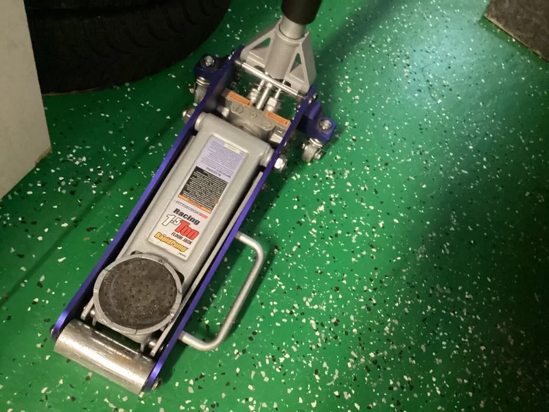

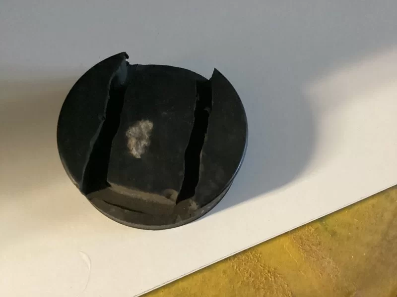

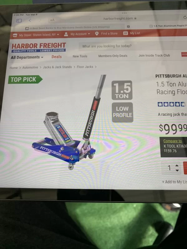

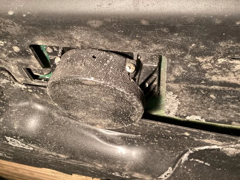

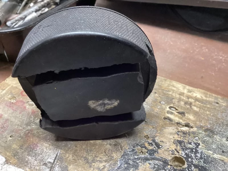

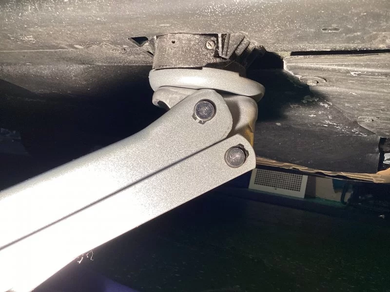

4 hockey puck/$6 cut groves for existing plastic factory lift points , screw a pucks with 3/4” screws and a Harbor Fright 1 1/2 ton Jack $100 and a little imagination how I did looking at pictures

Curious why you permanently attached the pucks, especially if you are jacking one side at a time. You can buy some with the proper design, I’ve seen 4 packs for $12 or higher quality ones for $20.
Those are really heavy duty and I don’t have to look for them any time I lift a car and when I paint calipers I take all 4 wheels off at once . They handy there when I rotate a wheels.I’m going to keep SE for long time .
