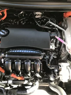

Using Rob’s experience on where to wrap the inductive pick up wire, I then found a mounting location that does not interfere with the removal of the top cover on the engine. So easy installation with no permanent modifications and easy replacement if this cheap Chinese knock off hour meter fails in the future.
So here the process I used:

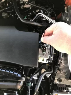

1 Remove top over to expose spark plug coils.
Tip: You will see 2 posts in rear poking up through the rubber grommets and there are 2 hidden under front of cover. Just pry/pull upwards. (use a q-tip and apply a tiny amt of silicone grease to posts and it will come off much easier in the future)

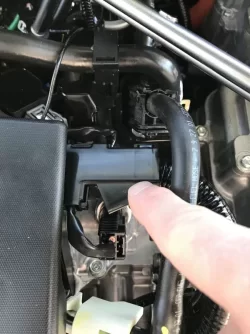

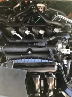

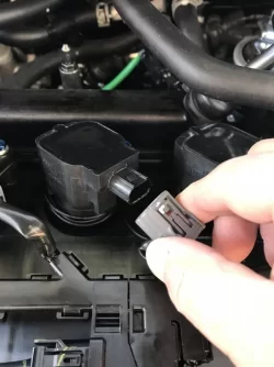

2 Remove the wire harness from the coil on the second from right.
The right most one is too hard to see the slot you have to fish for wire through.
This is to make it easier to wrap the wire around the coil. Tip: Use a small screwdriver to gently pry up tab on top while pulling off harness.

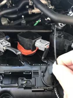

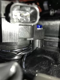

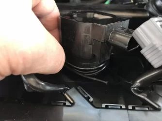

3 Wrap the wire around the coil leaving enough to reach one inch past the end of the metal bracket just to the right of where the top cover was.
This is where the meter will mount and the wire must run the full length of the meter. I was able to get it to go around 5 times. This is a bit of a challenge since you have to fish the wire through a slot between the coil and the bolt/post that holds the coil in place. Patience and needle nose pliers are helpful. See picture.
4 Make sure the wraps of the wire around the coil are tight and secure them.
I used self fusing silicone tape ( orange in the pix) so it will never come loose.
6 Replace the wire harness you removed. It snaps into place.

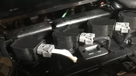

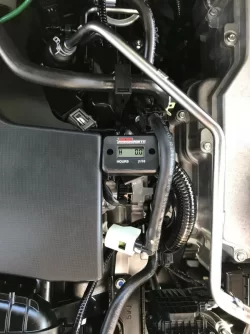

5 Attach the end of the wire to the full length of the slot on the bottom of the meter.
Push in gently with tip of screwdriver.
6 Mount the meter to the metal bracket.
See pix. I used some good double sided foam tape I had lying around.
Tip: Clean bracket and meter with rubbing alcohol for good adhesion. I had to pull the small hose on the right side of the bracket about 3/8” towards me from its clamp by the bracket so meter would not rub on the hose.
7 Replace top cover and you’re done!
Note that the ICE will have to run for 6 min for first reading to appear (0.1hr).
Thanks to Rob for telling us where to wrap the inductive wire and that it works there. Took me about 20 min and most of that time was getting the wire around the coil. First time ICE will crank up is a trip tomorrow. Will post what happens and what meter reads.
