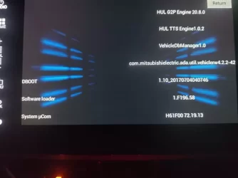

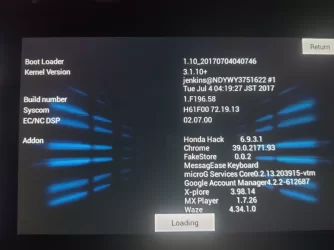

Are the software versions being discussed here different from what's displayed in diagnostics? Refer to pictures:
Yes, what is being discussed here are all the various TSB's (listed in Post #6 above). The revision of the head unit that you depict would also be of interest, but no TSB's have been issued against the head unit that I am aware of.
I was just thinking maybe a simple comparison of these version data fields would be sufficient for the OP to address his question.
