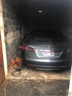

  • Sometime in early Dec we decided to spend the winter in Park City. I had a brilliant money-saving idea to move my Model S from our NYC lot to a much cheaper NJ lot. Naturally I asked if they had an outlet, and they said yes. Well, my wife goes to park it on Dec 22nd and it's the tiniest storage space in the world, and the plug isn't right in the same space.
    thumbnail
    We're leaving for Colorado the next day, so we sort of have to go with it, and I plan to have someone plug it in if/when necessary, as we have an extension cord. At this point in time I didn't realize two things: 1) Teslas have 2 batteries - a 12V and the main battery and 2) if you let both batteries die for several months, neither can ever be resuscitated. The 12V is only a few hundred dollars, but the main battery is $20k.

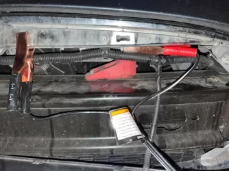

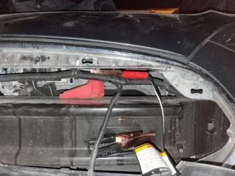

    I hook up the constant current charger to the positive and negative. Because I'm CLEARLY NOT a car guy, I message KMan and ask him if I've set it up correctly. He informs me that the negative cable is on plastic, and won't work. I move it to metal, and I think I'm good to go.
    Wrong way:

    Right way:

    5 minutes after charging the 12V at 2 Amps, the whole Tesla comes to life! KMan wasn't even sure if any of this plan would work, so that was MUCH quicker/better than my expectations. I thought I was in the clear, and everything would go smoothly. To be continued . . .
