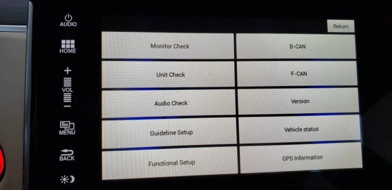

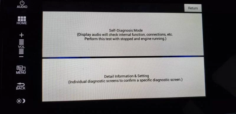

1. Press AUDIO, MENU, and * (light control) at the same time, and hold for a few seconds. It will change and give you a screen with two menus.
There are all kinds of information that you can get from here. You'll discover that even the Base Clarity has GPS built-in. It may not have the app in the head unit, but it knows where you are.
If you want to disable the "Don't Do This While Driving" setting, continue following these instructions. It will only work for this session. If you wish to repeat, you need to do it for each drive. With practice, you can get it down to about 10 - 20 seconds to get there.
2. Press and hold MENU until it changes to a screen with 10 menus, 5 on each side.

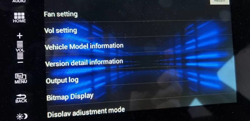

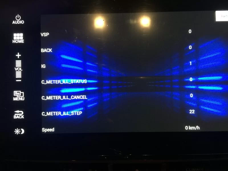

3. Select "Vehicle status" on the screen.
4. Select "Vehicle Model information" on the screen.
5. At the bottom of the screen, select "DD VSP Error".
6. Press the button and change it to "Off"
7. Press "BACK" until you get back out of these menus.
You can now access functions while moving as if you were parked.
