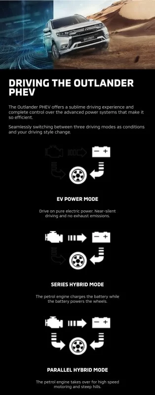

The Outlander PHEV can't do that; it must use the gas engine to power the drivetrain thru an ordinary transmission.
This is incorrect. The Outlander is the same as the Volt. Single speed transmission. Can operate all ev, and serial and parallel hybrid.
Okay, what I had read before is wrong. But you are over-simplifying it. According to the diagram below, the second electric motor which drives the rear wheels, drives an independent EV drivetrain.
Presuming the diagram is accurate, it would be correct to say the front drivetrain is a combined hybrid drivetrain, just like that used in most other PHEVs... as you said.
Anyway, it does rather sharply contradict most of what I posted above. :( The Outlander PHEV isn't merely a gasmobile which has an EV powertrain added to the rear, as I clamed; and it doesn't use a normal gasmobile transmission.
So thanks for your input, Gooki; I learned something today!
Yes the rear motor is all electric.
I believe the German's (BMW, Audi) are still using multispeed transmissions in their PHEVs.
They clearly state it on their site
Serial only would be even cheaper
