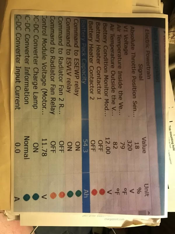

I took mine back in 4 months after purchase and 6 m after mfg (car mfg date 11/17) to have the BCS checked. It was 54.3 (Nominal is 55 Amp hours). So OK, but I bet I lost a little bit of my battery by it not being charged regularly.

I asked for a copy of the test and my service advisor was kind enough to print out a picture of the diagnostic screen for me.
