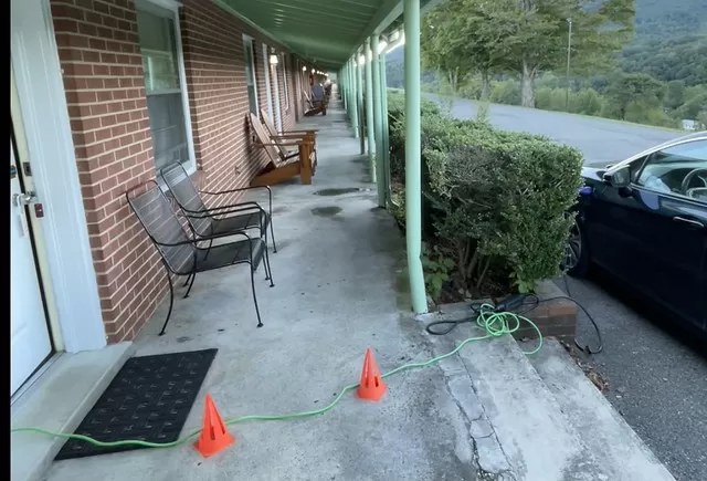

We’re on a quick vacation along the Blue Ridge Parkway. The motel owner said he didn’t mind if we charged overnight for 2 nights, so we did:
Most of the trip in HV mode regardless, which is fine.
