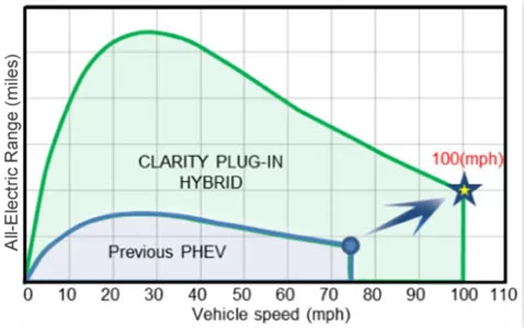

Using this chart thanks to insightman:
It shows the Clarity range is about 47 miles at average speed 15mph, 55 miles at 30mph and 48 miles at 45mph. I measured the Clarity heater uses about .2 miles per minute when the outside temperature is 25 degrees. So based on those figures, I produced the following chart:
Speed miles/min heater total m/min 0 miles after actual traveled if heat=.1
Miles/m Miles
15 mph .25 .2 .45 104.4 min 26.1 33.6
30 mph .5 .2 .7 78.6 min 39.3 45.8
45 mph .75 .2 .95 50.5 min 37.9 42.4
The last field shows that for warmer temperatures where the heater is using .1 miles per minute, the actual traveled miles would be much higher.
Sorry, I can't seem to get columns to align properly. The columns should read:
Speed, miles/minute, heater Miles/minute, total miles/minute, 0 miles after miles, actual traveled miles if heater used .1 miles/minute.

The temperature was set at 70. I sat with the car turned on but not moving for about 20 minutes with a stopwatch. When the EV mile would drop, I would make note of the time. On average, I would loose 1/10 mile every 32 seconds. The outside temperature was about 26 F degrees.
I don't see where you think the heater use increased mileage. At 30 mph for example without heater use, I show the car should get 55 miles of EV with a full charge. With the heater using .2 miles per minute, you could only travel 39.3 miles, if the heater is using .1 miles per minute, you could travel 45.8 miles. Both of those numbers are a reduction of the 55 miles of EV with no heater use.

I guess I didn't read the columns correctly. Thanks for posting this. Heater use effects on the battery is good Clarity data info.
