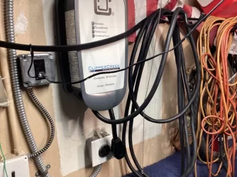

4A423809-A2BA-4480-B717-B89573EE8FBB.webp NEMA 14-50 I use since 2016
