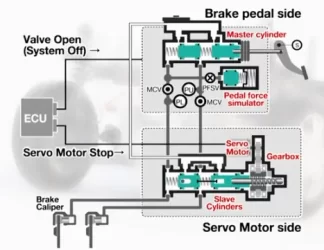

You peeked! I just googled. I guess the electric servo must activate the hydraulic system. The servo must be strong enough not to need a vacuum-powered master cylinder? I hope there's not a fuse between the brake pedal and the servo!

@insightman, you are my hero! So the servo motor is what magnifies our pedal effort when pure regen is not enough to slow us down.

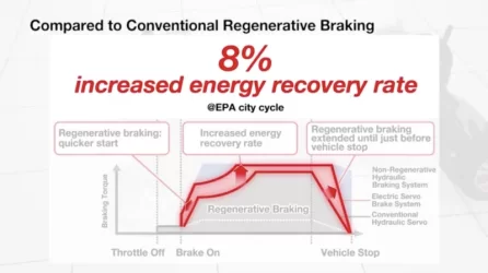

I watched the video and it has a very interesting graph on how Honda maximizes regen when we brake better than most other EVs. Also interesting is how we get a simulated brake pedal feel even when it’s all regen and no caliper pressure is applied. A beautiful piece of engineering all the way around.

The Clarity definitely uses a servo motor to assist the braking as @insightman showed on the video with his great find on the Fit’s system.
So the servo motor is magnifying the hydraulic pressure like the old engine vacuum used to do in my 08 CR-V???
What’s really neat is how Honda figured out how to get more regen than other cars and keep the regen going longer into the stop.
Check out this graph from the video:
I find it’s possible to slow by regen 100% except for the final 5 mph or so if you don’t run up to the next stop and brake at the last minute and his graph shows why.

It’s definitely hydraulic. Just look under the hood and see diagram posted by @insightman. It’s assisted by a servo motor to give us power brakes. So just like old school engine vacuum assisted power brakes, you still have manual brakes even if all else fails. And as in all cars there are two separate fluid paths for front and back so a leak in either line wont leave you with no brakes.
So I think it’s just like the “old timey” brakes except the power is from an electric servo motor instead of engine vacuum.
