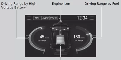

You cannot force your Clarity to run only on EV, however, you can run on EV only if you restrain the extension of your right ankle. You can see on the Power/Charge Gauge in front of you how much power you can use before the engine is activated. In ECON Mode, the engine won't come on unless you press hard enough to overcome the "click" resistance point in the accelerator's travel. You can select the Energy Flow Screen on the center display to see when the engine is activated. A gear appears between the wheels on that display when you are on the e-way and driving steady enough to engage Engine Drive mode, where the engine directly powers the wheels through a single-speed transmission (sort of like the Volt does, but only 1-speed, like a 5th gear).
There is no way to see separate MPG readings.
