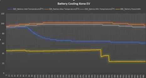

Charged on a hot day here in Central Florida at a 50kw charger. 45% to 85%. Battery Temperature went all the way up to 102.2 F/39 C but it appears that battery cooling worked flawless..

wow, 45C is seriously hot.. but based on statements from Hyundai UK, the system will not shut down until it reaches 60C..

On a recent 895KM day trip to Kelowna and Kamloops, my last DC charge was in Kamloops. 32 C outside, charged 40 to 80% before hitting the Coquihalla on last leg home to Langley. Battery temp at 48 C going up the 'hill' at about 110 KMH. Stayed at a steady 48 C until grade levelled off some. Charge time was 41 minutes at PetroCan. Excellent trip. As a side mention... next time we'll pack lawn chairs so that we can wait in the shade during charging. :)
