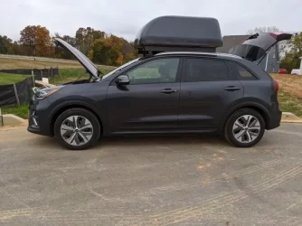

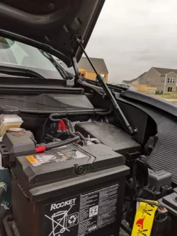

The following kit installs in a 2019 Kia Niro EV EX Premium without any drilling or custom fabrication and fits properly: https://www.aliexpress.com/i/4000030029320.html. However, the dampers themselves are higher pressure than they should be; I am currently only using one side while I look for lower pressure replacements. In the meantime, I have an idea for a poor man's cheap and easy "frunk" solution that I will test in the next several days; details to follow...
Pics...
