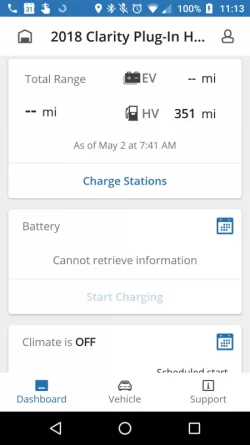

I should have made this clear earlier - I had already completed the setup steps as shown in the video. I have set my self up as the primary driver and we just use the same login on my Wife's phone too. With that said, here (attached screenshot) is what I'm seeing now when the car is sitting at a parking lot about 20 miles away. But when the car is home in the evening, I see proper values for both 'EV' and 'Battery'. I'm wondering why the discrepancy based on the car's location.

Aperson, it works all the time for me. Home and when out shopping/eating. I’ve never seen this.
Now it is normal not to get instant updates and have updates “lag” as in not having real time updates. This is because Honda is paying for all our Honda Link bandwidth w the cellular carriers. To save on $/bandwidth, only certain events will trigger an update such as car turn on/off, charging started/stopped, and at defined SOC (every 15% I think).
One suggestion to trouble shoot this is to have your wife check at that location that car is getting a good signal at the time you try your HL. At shutdown she will see an antenna symbol and signal strength bars on the DDI (view thru steering wheel). Also if at same time you can’t get it to work, can she do it from her phone? And does it do this at other locations? This will possibly help narrow down where the problem is. Might also try doing the secondary driver thing in case both of you using same log in is messing it up somehow. (Hey, stranger things have happened) And remember that HL doesn’t work when car is moving.

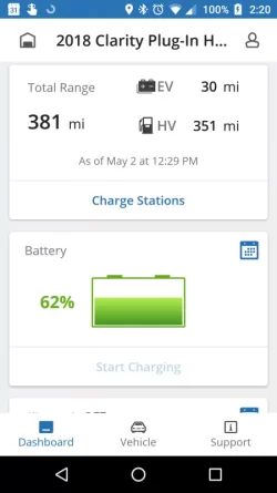

KentuckyKen, I think you are spot on about only certain events triggering the update. I was playing around with the app and think figured out how to trigger an update. Went in to 'Vehicle' --> 'Find My Car' --> 'Locate Vehicle'. Figured that when locating the vehicle perhaps there is a chance that the Range/Battery numbers are also updated. Bingo!!! Attached screenshot below. Notice the 62% battery remaining after a 26mile drive. That is about 28 cents cost base on my rates. Cannot stop smiling!! :)

Great!
FYI: some have reported odometer not updating every time rest of info updates, but mine has only done that once and only for one day. Thanks for observation that find my car can trigger an update. Good to know.
