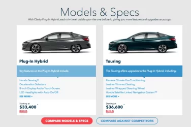

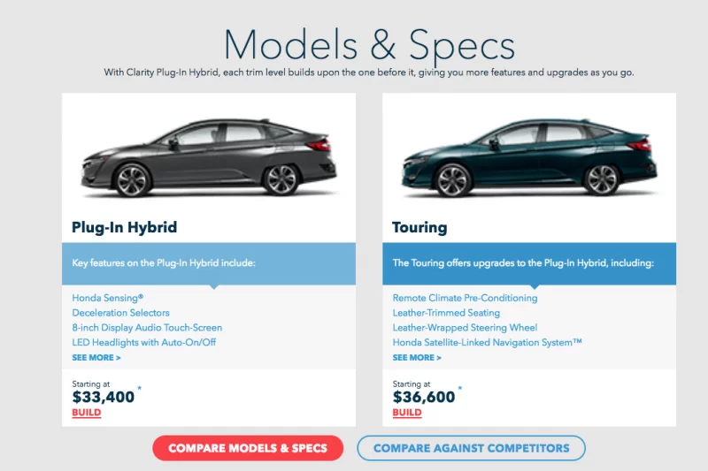

Honda lists "Remote Climate Pre-Conditioning" as a touring feature. I wonder why, if in fact it's available on the base model as well. Screen Shot 2018-07-05 at 10.57.11 AM.webp

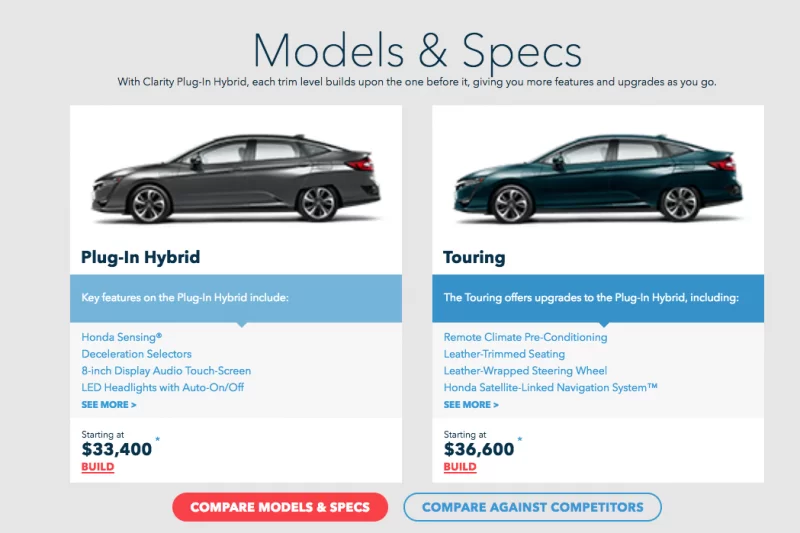

Honda lists "Remote Climate Pre-Conditioning" as a touring feature. I wonder why, if in fact it's available on the base model as well. View attachment 1484
so this is what my Honda sales guy told me yesterday (just bought Clarity yesterday - base model). the button on a remote/keyfob will only work with touring model. I am yet to try the climate pre-conditioning via the Hondalink app. My understanding is that Hondalink will only work if the car is park outside with satellite link.
Car doesn’t use a satellite for HondaLink. It uses a cellular connection. As long as both car and phone with app can connect to Honda’s server, HL will work. You can check your car’ connectivity by the number of bars by the antenna icon at shut down when TCU appears or on center display.
Your salesman was about as well informed as mine (as in not at all).
A previous discussion in this forum on the topic saved us $3K, as this was the only feature we really cared about enough to push us to the touring. I can confirm that it works, and works well, on the base model. We use it almost daily. The only annoyance is living somewhere with spotty coverage. Our salesperson was clueless about it (and pretty much everything about the car) as well.
