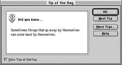

There's always hope, as suggested in a timeless Tip of the Day from an early version of Microsoft Word:
