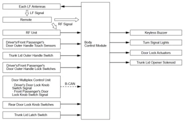

Service manual 3323 (Keyless Access System Description) for the Clarity states that "The body control module can store up to 6 remotes with the HDS.", so I guess this applies to all trim levels.
AFAIK, key fobs cannot be paired with the car without using an OBD II/CAN diagnostic tool (e.g., with i-HDS software).

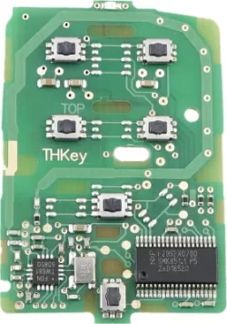

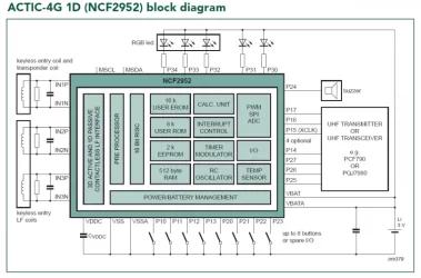

The bare PCB for these sub-variants is identical, but they are loaded with different button positions. There are different variants of the fob (KR5V1x, KR5V2x, KR5V3x, KR5V4X). It's unclear if there are firmware differences in the fob's NXP ACTIC-4G 1D (NCF2952) microprocessor.

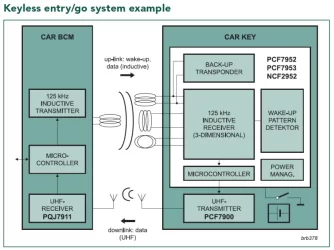

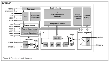

V1x and V3x transmit at 313.55 and 314.15 MHz. V2x and V4x transmit at 433.66 and 434.18 MHz. All use FSK modulation (perhaps with Manchester encoding?). The fob also has a set of three low-frequency antenna coils (one in each axis: X,Y,Z) for short-range detection. I imagine that they used for sensing the distance of the fob from various sensors, but perhaps it can also be used to wirelessly power the fob when it is close to the ignition button (used in case the fob's battery is dead) and disable the immobilizer.
