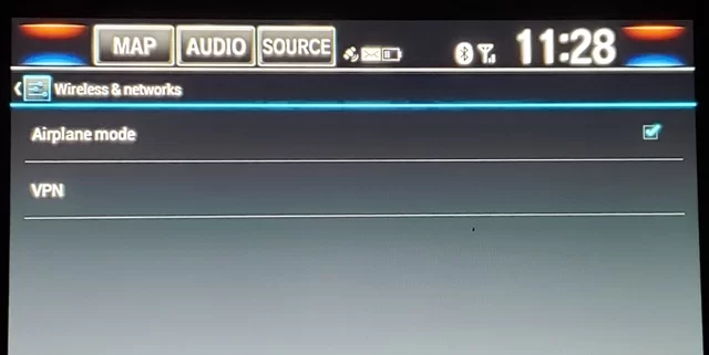

You can even put your Clarity into Airplane mode if you want to. And that's not even a backdoor, with enough poking around you can get to this screen.
Although I'm not sure at what altitude Airplane mode is required.

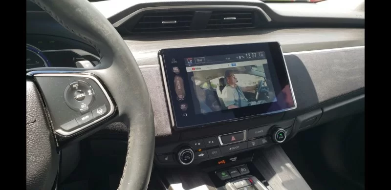

I have only had my Clarity two weeks tomorrow. Yesterday I was waiting for friends, sitting in my Clarity for about an hour having some time to kill I played with the browser. Mine came with it. I connected it to my phone hotspot and was able to go to and play Youtube. Your phone will most likely work better but it does work on mine with audio coming thru the speakers as should be.

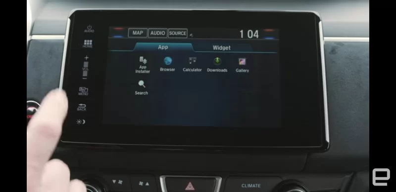

I don't see any Honda Hack listed on my vehicle however I just came across "Honda Clarity| Hands-On" on YouTube from Engadget two years ago, reviewing the brand new Clarity and at 4:40 he states the Clarity comes with a browser and app installer. The next screen he shows looks just the same as mine does... see attached screen shot from YouTube video.
P.S. Quick search of Honda Hack says to use the browser to install.:"Honda Hack helps you to install apps on your head unit and tweak the system. Honda Hack can be installed directly from the Browser app of your head unit .."View attachment 5763

I wasn't recommending Honda Hack, merely pointing out installation instructions say to use the browser to install. I guess some have said the Clarity doesn't come with a browser or browser access with out hacking. I don't know. Some automotive journalists have showed the audio/touch interface and there was a browser in their review videos.
