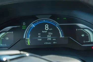

Yet again, the icon that shows "D" or "R" or "N" or "P" is entirely distinct from the icon that shows "EV". They are two disparate indications, shown in separate locations on the display. Neither has anything at all to do with the other.
(image source: https://carswithplugs.com/2017/12/18/2018-honda-clarity-phev-initial-review/comment-page-1/)
The picture above minus EV is what I’m now experiencing. It just shows D, no EV despite being fully charged. This never happened prior to software updates. I don’t know what the software updates pertained to. I just know there were 4 of them. The dealership referred to them as “recalls.”
It looks like you need to turn Econ mode back on by pushing the Econ button above the gear selector buttons. The dash will briefly show Econ Mode On in the center display and you will get an icon of green leaves above the D in your picture.
My guess is that either it reset to off when they did the updates or the dealer turned it off when doing a test drive after maintenance. In Econ mode the ICE will still turn on if needed, but you have to push past the click point on the accelerator.

The D is for Drive and was probably always there. What you are missing is the EV and it is using more gas. I think the others are correct, one you push the Econ button the car will favor EV as much as possible.
