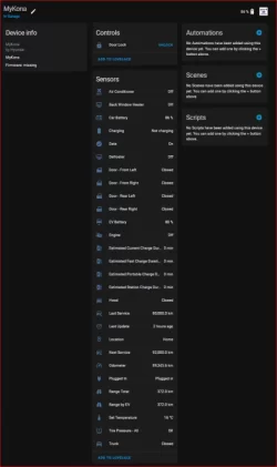

This is an example of the web page that HA interface generates.

Here is the complete list of sensors the integration exposes.
There is also a geo-location setting which I have not tested.
