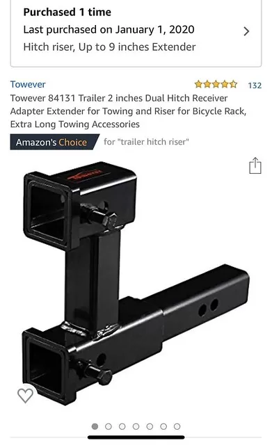

True. This helps a lot for that issue:
Right idea. Some hitch risers, rather than a dual hitch
Seems like those may add unnecessary instability, especially with a heavier ebike (50-60lbs). It seems like that would add extra torsional stress on the rack and lower capacity. The rated capacities assume you're attaching directly to a stable hitch with the included hardware and assume the bike being within a certain distance from the vehicle.
Most of the better bike racks already raise the bike from the hitch level. If you raise them even more, how will (usually older with ebikes/e-assist bikes) people easily lift their 50-60lb bike higher to get it onto the rack?
Even without assuming older people trying to load their ebikes -- yes, (mid 30s) I've lifted my mountain bike onto a roof rack on my prior car and I had no issues. But ease of use was still one of the primary purposes for a nice hitch mounted bike rack for me. Not advising people against going this route, but just to consider ease of use and stability.
Check the rating. I used a drop down/riser on my motorhome to tow a car. It is rated at 10,000lbs. The hitch on the Clarity is only rated at 2000lbs with a 300lb tongue weight. The risers will typically be rated at 4000lbs or more. There are anti-rattle devices available that will stabilize the added component.
My “high end” Küat rack extends a considerable distance directly out of the hitch and has a knob at the end which jams the rack into the receiver to prevent rattling. Depending on the rack, an owner will need to determine if a riser is necessary to suit their needs.
What the rack is attached to doesn’t change the rating of the rack. Personally, I’d be comfortable adding a riser to the Clarity hitch and loading a bike rack to it’s maximum capacity, as long as the weight of the rack and bikes did not exceeded the 300lb tongue weight rating of the hitch. I see little to no risk of overloading the hitch or rack, and a greatly reduced risk of damaging the rack or hitch from jamming it into the ground.
As far as not being able to lift a bike on to a rack that is 4-6” higher than without the riser, I’d say it’s time to hit the gym.
