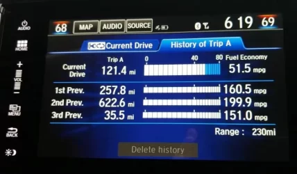

There's a weird bug in the tablet software that displays the Trip 1, Trip 2, and Trip 3 history in miles and mpg. I assume others have noticed it, but I thought I'd check.

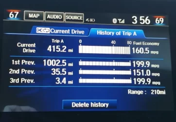

After buying the car, our first "Trip A" was 1002 miles, and the tablet duly saved it with our mileage (199.9!). Our second trip was 415 miles, at a lowly 160.5 mpg, which the software also saved.
At some point, those two saved trips had their miles reset to 622.6 and 257.8 miles in the "History of Trip A" display. A quick calculation shows that is the exact conversion from miles to km. It's as though the software thought the original mileage was actually km and converted it (by .621) into miles! (The "3rd Prev" was there when we bought the car. I suspect it was originally 57.1 miles.)
I'm guessing this ain't gonna get fixed without a software update from Honda. (Unless there already is one??)
Good catch. Maybe the miles-km option was switched at one time? It's fairly easy to inadvertently access on the drivers display as opposed to the multi-level options menu on the centerstack.
I tried switching it over to km and back to see if that cleared it, but it didn't. We've never had it set to km. Possibly someone test driving it at the dealer might have, but it was always miles since we've owned it. I'm guessing it's happened twice, since our trips were originally displaying correctly as miles and now they aren't, yet the original mileage (Trip 3, now) hasn't changed since we got it. I'm guessing it changed also back at the dealer, but I don't know. Otherwise, it means the top two got changed, but the bottom wasn't. Weird, right?
As long as the actual odometer isn't changing, at least it's just a minor annoyance. If the odometer ever changes that'd be a big deal worth a recall.
